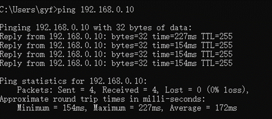

Everything's fine at this point : I can ping 192.168.0.10 and get replies.Hamaos_0-1718185156794.png

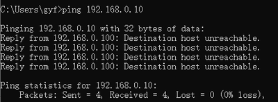

However, after I Modify the StartDefaultTask in main.c , I can't ping the device and get some debug information from uart :
How to deal with "core lock " in the debug information ?
This is the StartDefaultTask code modifyied:
