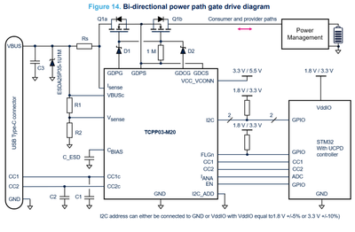

We plan to use STM32G0 mcu with UCPD interface and external TCPP03-M20 protection circuit with single bi-directional power path in our smart power bank with replaceable smart battery and USB-C PD dual role power port application. There will be one USB-C PD connector. And there will be TI BQ25731 Buck-Boost Battery Charge Controller with USB-C PD 3.0 OTG Output that is why we need single bi-directional power path

1) We plan to offer special non USB-C PD cable which allows to connect directly 12 - 20 V "not power delivery" power supply to USB-C connector. For this scenario, we would like to be able to control single bi-directional power path through TCPP03-M20 mosfet driver directly to enable this non PD power path to connect to battery charger (BQ25731), is it possible to do so?

Hi @pavelvavra
Interesting application, first, here is an example of two small signal Schottky diodes (D1, D2) to merge the paths while preventing reverse current flow and a 1 MΩ resistor for biasing. Check datasheet for electrical characteristics.
TCPP03-M20 route the power from the power supply to the BQ25731 charger through I2C commands.
