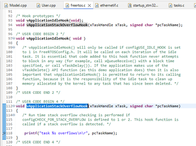

If CHECK_FOR_STACK_OVERFLOW is not set to 0 (Disabled), the application must provide a stack overflow hook (or callback) function: void vApplicationStackOverflowHook( xTaskHandle xTask, signed char *pcTaskName );
The kernel will call that stack overflow hook whenever a stack overflow is detected
Note: when set to 1 or 2, a function with an empty body is generated in the freertos.c file (to be completed by the user)

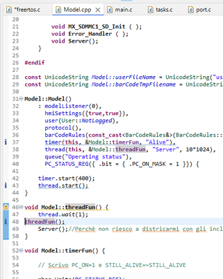

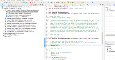

So I set CHECK_FOR_STACK_OVERFLOW = 1, trigger a stack overflow by an infinite recursive and set a bkpoint in
But when I run the code I just reach HardFault_Handler
What am I wrong ?

Not in this case.
The check is done when tasks are switched which happens on the millisecond scale. If the overflow happens before then and a hard fault is produced, it will not be prevented. Calling a function recursively will overflow the stack very fast. It is not a magic solution that works all the time without limitation.

See here for how this works. It only checks when tasks are switched.
FreeRTOS stack usage and stack overflow checking - FreeRTOS™
