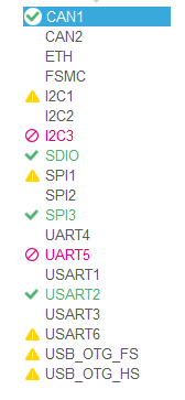

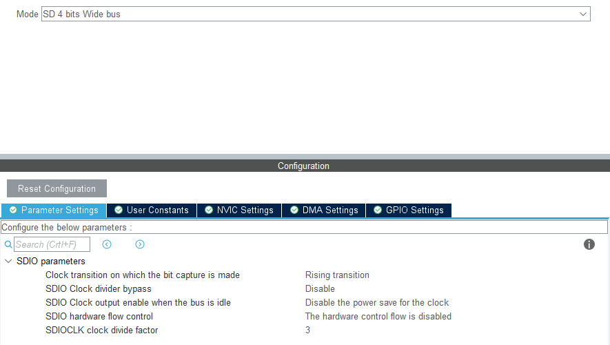

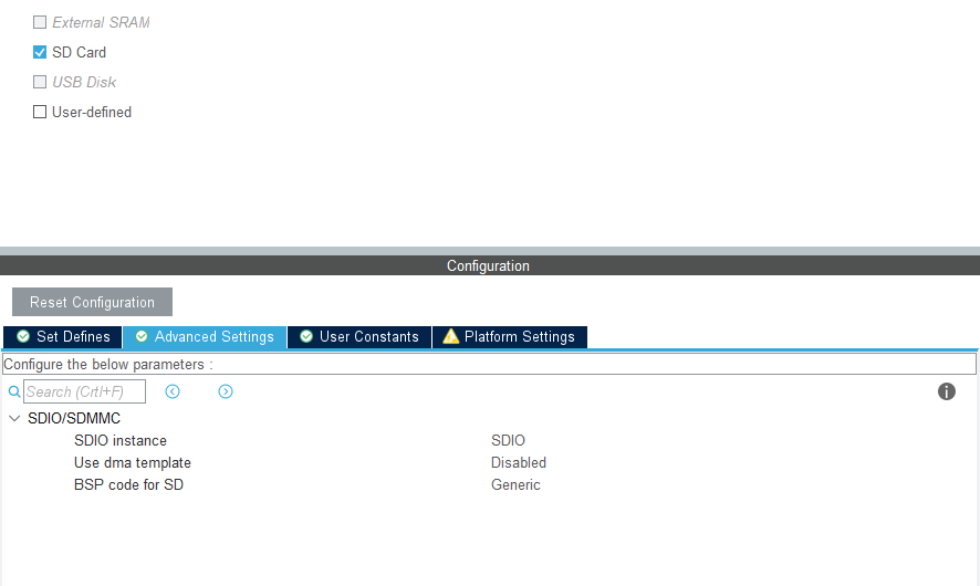

I dont use DMA, my settings
Could this be caused by the setup of CAN1/SPI3/USART2? Do they use same FIFO or something?
0693W00000FBzsVQAT.pngI have tried to increase "hsd.Init.ClockDiv", but id does not seem to solve the problem.
Could I somehow wait for FIFO to be available in my code? Is there somethink like f_waitForCompletion?
