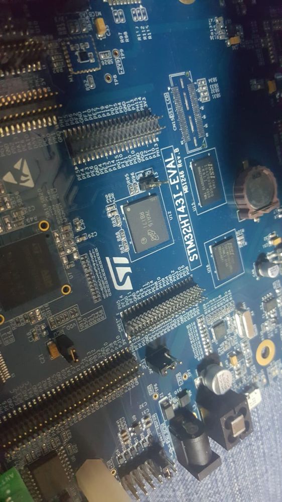

Hello Clive,
Can you please see image.
I don't understand.
In U12 , it shows 7KA15 (not like yours).
Yet, According to this page
https://www.micron.com/products/nor-flash/parallel-nor-flash/part-catalog/mt28ew128aba1lpc-0sit
It seems that I have mt28ew128aba1lpc (7KA15 is the FBPA name for the chip).
Another interesting thing I noticed, if is that systemclock_config has much influence on the time it takes to do the flash nor programming.
I still not sure which exact clock is responsible for this.
Thank you!
ran
