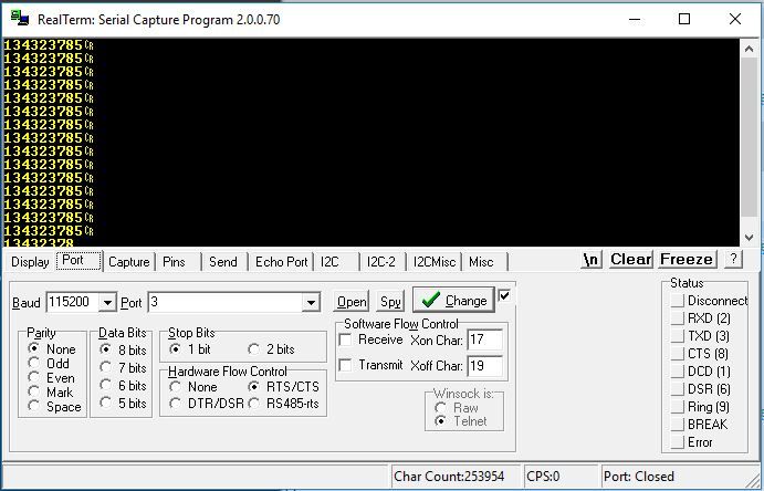

Hi all,
I am using an stm32f4 micro to generate a random number. I am using the RNG Driver from the stm32cubef4 library. I followed the examples but the micro is generating the same number over and over again. here is a code snippet.

Does anybody have a clue on what am missing. I am using the DEBUG_PRINT function to get the random value through the serial port. Best Regards Raiyan #no-hablo-hal #stm32f407-random-number-generate

Posted on November 10, 2016 at 20:18
What does it actually output?
The RNG must have its AHB clock enabled, and the PLL Q must be clocking and outputting 48MHz. Things won't work if the PLL isn't running.
Review the Reference Manual, examine the registers and settings directly.

raiyans
Posted on November 11, 2016 at 10:56
There you go ;)
I have initiated the rng clock as suggested in the documentations.

raiyans
Posted on November 14, 2016 at 12:01
Hi clive1,
I finally managed to solve the issue. What I was missing from the code is the instance initiation and a correct PLL clock initiation

and also I might have not configured my PLL correctly. Now I configured it as follow
