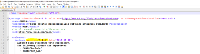

2024-09-09 12:50 AM - edited 2024-09-09 1:28 AM
Hello @White_Fox and welcome to the Community :),
Which CMSIS version are you using?
-->The first difference is, that I do not have a folder "PrivateInclude"
Note that, the CMSIS version integrated in STM32CubeF3 1.11.5 is "5.4.0".
As mentioned in this FAQ
- If you use the 5.8.0 version of CMSIS or higher, follow the steps shared in How to integrate CMSIS-DSP libraries on a STM32 pr... - STMicroelectronics Community.
- If you use a version of CMSIS less than 5.8.0, refer to Configuring DSP libraries on STM32CubeIDE - STMicroelectronics Community to add the DSP libraries in your project.
Thank you.
Kaouthar
2024-09-09 1:27 AM
Thank you KDJEM.1, this works definitly much better.
Indded, I'm using the latest firmware version 1.11.5 with CMSIS version 5.4.0.
But after following the article, I still have one (hopefully last) problem. I just included the arm_math.h file, make comes up with an error. The error message is this:
make: *** [makefile:64: SPV.elf] Error 2 SPV C/C++
Do you have any advise how to solve that?
