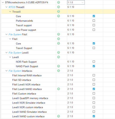

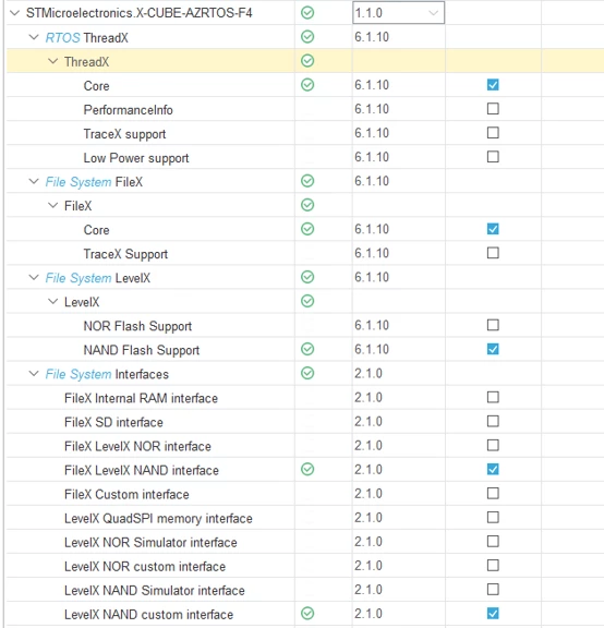

The software components I have selected in Azure RTOS are as shown in the image:
I also doubt if my implementation of W25NXX_Read_Spare_Area and W25NXX_Write_Spare_Area under lx_nand_driver_extra_bytes_get/ lx_nand_driver_extra_bytes_set.

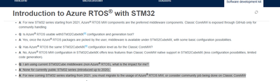

We found that Azure FileX documentation is not in a mature state yet to start shifting our work to it and have shifted our focus from FileX to LFS and dhara which we got working very easily.
We would like to see more examples and more documentation on Azure and its all other offerings. There is not enough documentation and examples to look for.
I find it strange to see ST pushing Azure over classic CoreMW without providing proper documentation and examples, as can be seen in this photo. Also I found it very difficult to configure Azure and other offerings through IOC file.
