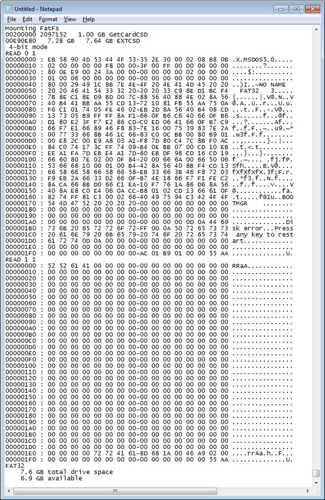

It is a file system on top of a block storage system. There are partition tables, boot sectors, directories, and block tables associated with writing your text to a file.
You should dump the 512 bytes in the block to better understand what is in this one. My guess would be your test string is in a preceding block that was written.
READ 0 1
00000000 : EB 58 90 4D 53 44 4F 53-35 2E 30 00 02 08 B8 0B .X.MSDOS5.0.....

READ 1 1
00000000 : 52 52 61 41 00 00 00 00-00 00 00 00 00 00 00 00 RRaA............

Forest L
Sorry, where/how would I 'dump' the block contents?
By the way, I'm attempting to use DMA, and realize now that there are two interrupts attached to the SDMMC interface -- can this cause problems if they're not correctly configured and are maybe overlapping?
void SDMMC1_IRQHandler(void)
void DMA2_Channel4_IRQHandler(void)
You'd instrument the disk_read and/or disk_write functions to call dumping routines that show you what's in the memory buffer.
