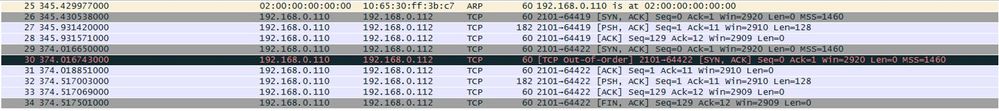

Hi, I got a problem when I use the Ethernet TCP stack and hope someone can help me figure it out.
I am using tcpecho protocol to communicate between PC and the board. PC send the command and board response with the data. If I just send 64 bytes, as:
netconn_write(newconn, TCPResponse, 64, NETCONN_COPY);
Everything looks good, I can see the PC receives the response as :
but since my message is over the 64 bytes, I change it to 128 in the function as
netconn_write(newconn, TCPResponse, 128, NETCONN_COPY);
Then the response become much slower. It takes more than half second to received the response.
Looks like I got the "TCP out of order", Is there any way can allow 128 bytes message in the TCP stack?
Please help me out of it. Thanks for that

When I set the 128 bytes, it talks, but much slower for some reason. Do I need to change anything to make it faster? I found there was a bug for the H7 as https://community.st.com/s/question/0D50X0000C6eNNSSQ2/bug-fixes-stm32h7-ethernet. not sure if F7 LWIP has the bug for 128 bytes argument.
Here is the Message got from sharkwire which shows the message timestamp.
64 bytes length

>When I set the 128 bytes, it talks, but much slower for some reason <snip> there was a bug for the H7...
The question is speculating if a problem in the F7 driver could cause 128 byte packets to be transmitted much much slower than 64 byte packets.
It's very unlikely. But very easy to test. Forget TCP for a moment. The STMF7 won't care. Just use ICMP (ping). E.g. from Windows...

Instrument your lwIp to determine where it's spending time. Then, when you find it, search the web for reasons for what you determined and its fixes.
Perhaps you can do nothing but search the web, and be lucky. E.g. a Google of "tcp transmit very slow lwip" (without the quotes) finds these and others...
http://lwip.100.n7.nabble.com/Slow-sending-speed-td7346.html
https://forums.xilinx.com/t5/Welcome-Join/zynq-lwip-transmitting-speed-issue/td-p/735522
https://lists.gnu.org/archive/html/lwip-users/2003-11/msg00009.html
But you'd still have to read the hits, and whenever you read a plausible cause, devise some experiments to confirm if that's your problem.
Also study TCP tuning for lwIP, e.g. https://lwip.fandom.com/wiki/Tuning_TCP.
