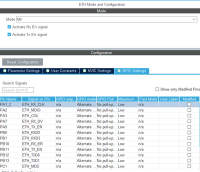

Here are my solutions form my project (STM32H725IGKx with STM32CubeMX (6.10.0)).
Problem was that I had HAL_ETH_ERROR_TIMEOUT. So the SWR bit (ETH_DMAMR_SWR) was not set to 0:

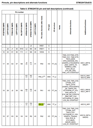

  1. There is a problem in Cube: The preset pin for ETH_RX_CLK is PA1_C. In the manule you will find that you need pin PA1 for ETH_RX_CLK! So you need to change register value that PA1_C is linked internally to PA1. I do it before HAL_ETH_Init:
SYSCFG->PMCR &= ~SYSCFG_PMCR_PA1SO_Msk;
  /* USER CODE END MACADDRESS */
  if (HAL_ETH_Init(&heth) != HAL_OK)
    Error_Handler();
I didn’t found a possibility to change it in the STM32CubeMX (6.10.0)
