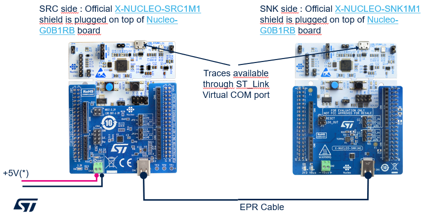

I'm working on new knowledge base article on How to create an EPR capable USB PD Source and Sink on STM32 using TCPP ports . For demo, VBUS is kept at 5 V even for higher SPR/EPR PDOs; only the protocol is exercised (not full EPR explicit contract).
Best regards,
FBL

Thank You, but I have sink device, not source.
Will the USB PD stack for STM32G0 support PD3.1 (EPR mode)? I have project with STM32G0 microcontroller because of low cost and unfortunatelly I can't use other uC.
I read that X-CUBE-TCPP supports PD3.1, but how to use it without any TCPP IC? Is it posiible any way.

Hi @Jaroslaw_T
Sorry for not getting back to you sooner. I will clarify this part in the article. Chucking is mandatory in EPR mode in PD3.1;
Now in your case I'm suspecting your handling of extended/chunked messages; can you test with the following source example. Here is my HW setup:
For my case, to store received SRC EPR PDOs
case USBPD_CORE_DATATYPE_RCV_SRC_PDO_EPR:
  if (Size <= (USBPD_MAX_NB_PDO * 4))
    uint8_t *pdo;
    DPM_Ports[PortNum].DPM_NumberOfRcvSRCEPRPDO = (Size / 4);
    for (index = 0; index < (Size / 4); index++)
      pdo = (uint8_t *)&DPM_Ports[PortNum].DPM_ListOfRcvSRCEPRPDO[index];
      memcpy(pdo, Ptr + index * 4U, 4U);
  break;
 Can you replace your source and attach it to the Sink with the proposed setup?

Thanks for the clarification @Jaroslaw_T .
Can you verify whether the source used advertises EPR capabilities using chunked or unchunked extended messages?
