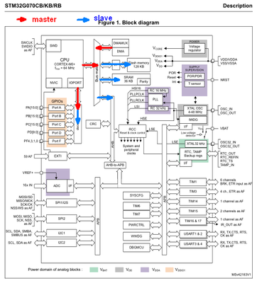

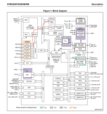

waclawek.jan
In 'G0, GPIO are connected to the cpu-private IOPORT bus, not accessible from the rest of the chip, i.e. DMA cannot access GPIO in 'G0.
Thank you very much.
Writing to BSRR or BRR register is also impossible?
DMA on GPIO must be possible following datasheet of the controller
waclawek.jan
No that path is not possible.
