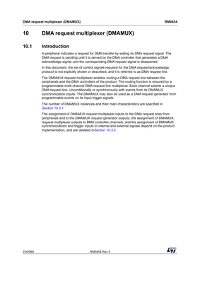

waclawek.jan
Read out and check/post content of TIM, ADC, DMAMUX and DMA registers.

The DMAMUX needs to be configured to tie the ADC to that DMA channel.

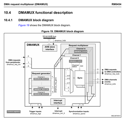

waclawek.jan
> I have already shared Initialization code in chat.
The mcu works out of the registers content rather than source code. There may be e.g. errors in the library you are using.
> STM32G070 (G0x0) there is no DMAMUX, and there’s nothing to tie.
> The ADC to DMA mapping is fixed in hardware: ADC1 → DMA1 Channel 1.
Where do you have this information from, AI?
Have you had a look at the Reference Manual?
As TDK said, you need to set DMAMUX channel related to the DMA channel you are using, the numbering does not match so it's DMAMUX channel 0. At the beginning of DMAMUX chapter you'll see the table of triggers, so enter the number related to given ADC to DMAMUX_CxCR.DMAREQ_ID, that's all. There certainly are LL functions and defines for these things, you can find them in Cube, which is open source.

> n STM32G070 (G0x0) there is no DMAMUX, and there’s nothing to tie.
Did AI tell you that? The Reference Manual says it's there. See the "Request Generator" part.
