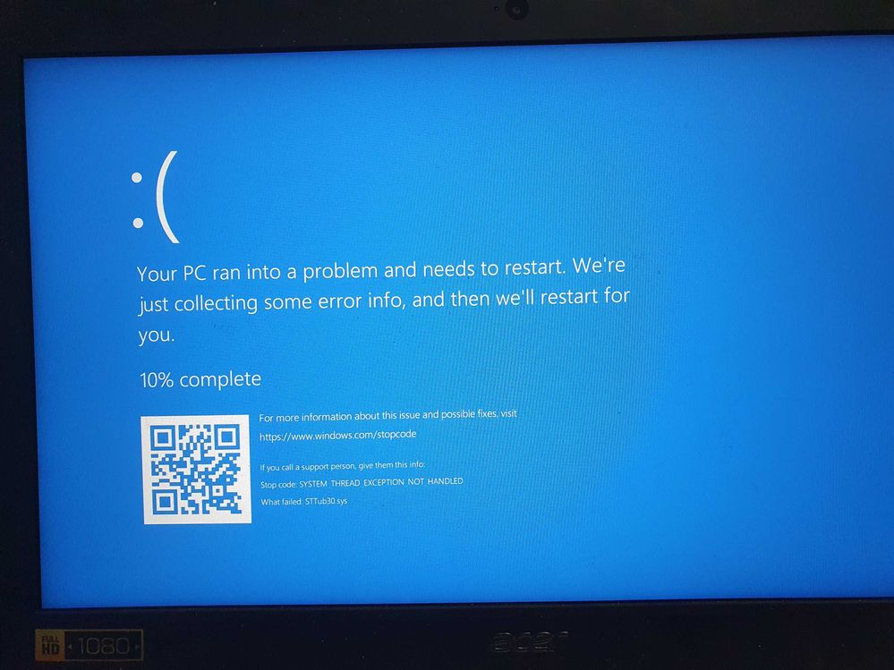

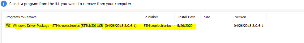

I'm using STM32L072KZT6 microcontroller, and I'm trying to make USB DFU Standalone bootloader. I've done many bootloader standalone firmwares for STM32 MCUs, for F0, F1, F3, F4 series, and had never encountered this kind of a problem. It's not deterministic, I've succeeded couple of times to write my firmware via DfuSe, and successfully run the main program, but in most cases it fails. Windows does not complain about the driver when the USB is plugged in, when I try to update it, it says that I'm already using the newest version.
The problem appears in the following moments:
  • When USB is plugged in
  • When Upgrade button is pressed inside DfuSe demo
I've tried different solutions, running DfuSe from STM32L folder, but nothing helped. My firmware is almost the same as an example for 32L0538DISCOVERY inside Cube L0 repository, and I'm using the latest version of L0 Cube firmware (V1.11.2). I've attached some pictures of the error message, driver version, and .zip file of my CubeIDE project.
Hope you can help me :)0693W000001pRikQAE.png0693W000001pRgPQAU.jpg

[UPDATE]:
I've bought the STM32L0538-Discovery board and I've successfully implemented the DFU-Standalone example.
There was a little bug inside the example, the flash string and erase method are not matched. From the flash string, the flash memory is divided into 1Kb sectors and the erase method erases only 1 page (128b, not 1024b). The result is the DfuSe demo waits indefinitely for the write operation. To fix this I've corrected the erase method to erase 8 pages which are equal to 1024b.
Secondly, I've managed to solve my issue with CubeMX v4. In CubeMX v5 I've noticed some problems:
  • For Eclipse Stm32 Workbench it does not generate a linker script, and I need to manually set the mcuId inside .xml file.
  • In my L0 project, it does not include SysTick_Handler inside the stm32l0xx_it.c, and the main program gets stuck in the Infinite loop
  • Also, in the usbd_conf.h file, it defines macro USBD_SUPPORT_USER_STRING_DESC, but it should be USBD_SUPPORT_USER_STRING
Obviously, there are more problems which I didn't catch, because when I've fixed those I mentioned above, I get the same result (blue screen). Those problems are not a big deal, but they've consumed a lot of my time.
I will mark this topic as "closed", but you must correct those issues with CubeMX v5. Till then, I'm using v4 :)

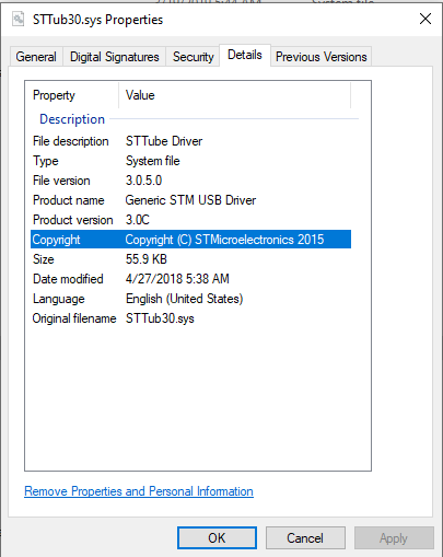

Pavel A.
What is the version (properties-> details) and size of your \windows\system32\drivers\STTub30.sys ?
-- pa
MLovr
0693W000001pUoRQAU.pngHi @Pavel A.​  thanks for your quick answer, the details of my STTub30 are in the attached picture. I've installed the driver from C:\Program Files (x86)\STMicroelectronics\Software\DfuSe v3.0.6\Bin\Driver\Win10

A Pica
I'm facing the same problem here with DFU3.0.6 but with an older driver version (not sure from where I got this specific driver version :\ )
  • STTube Driver:
    • Version 3.0.1.0
    • Product version: 3.0B
    • Date modified: 20/07/2012
  • STM32 DFU driver:
    • Version 3.0.4.0
It worked a couple of times and then just starts generating BSOD
MLovr
@Community member​ You can install the latest driver version from path I've posted above (C:\Program Files (x86)\STMicroelectronics\Software\DfuSe v3.0.6\Bin\Driver\Win10) but you need to install DfuSe v3.0.6 from ST official web site.
