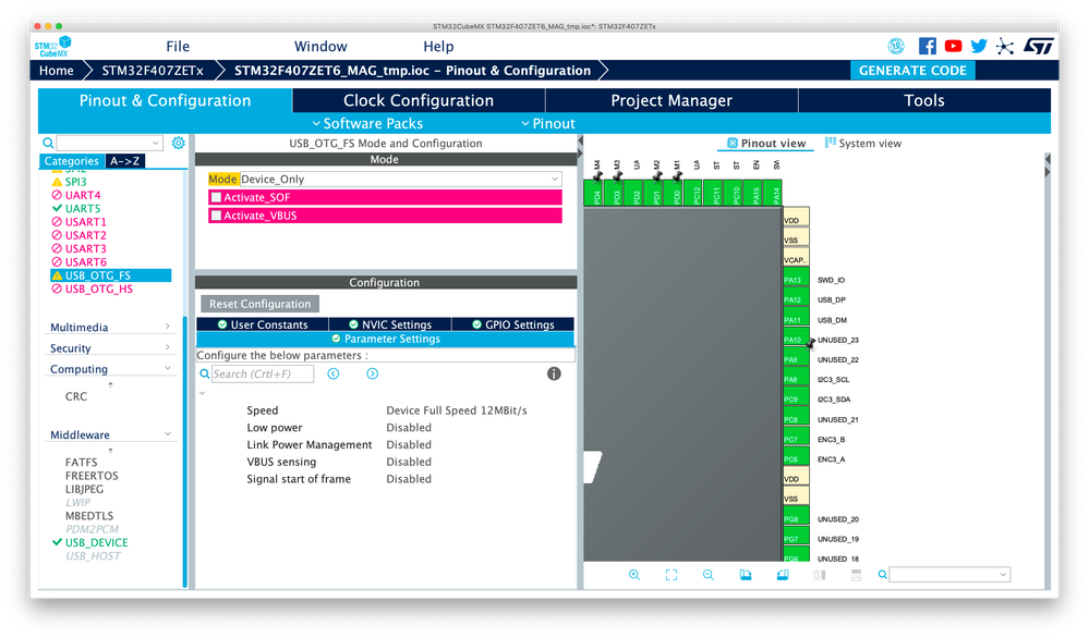

I wanted to implement a simple USB device only on a STM32F407. When I enable it in CubeMX under USB_OTG_FS I get a DP and DM line and there is an option to activate the VBUS line. Is activate VBUS absolutely necessary? It is after a simple device only mode. Also what is Activate SOF?
Also I tried implementing this on a custom board with just the DM and DP lines but I did not see any comms happening. The board is not powered from the USB. So I guess this is a self-powered device only mode. What am I missing?

‎2021-01-24 8:38 PM
If your board has its own power supply, you do not need VBUS and you should declare in your descriptor that you need 0mA.
If you are taking your power from the USB cable, you need VBUS and you should declare in your descriptor how much power that you need.
A self-powered device does not draw current from the bus.

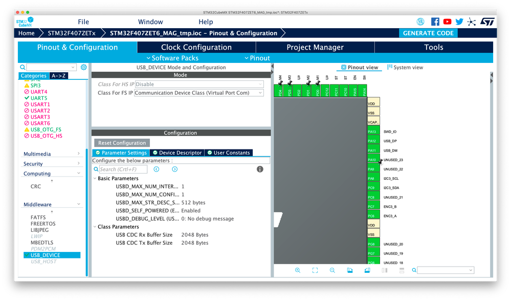

Where exactly should I add that? I see that the USBD_SELF_POWERED is enabled. Here are the settings as they are now.
‎2021-01-24 9:30 PM
It's a descriptor called USBD_CDC_CfgFSDesc in usbd_cdc.c.

‎2021-01-26 12:37 AM
Thanks. It seems according to this document (sec 2.6, page 10) VBUS sensing is mandatory if the device is self-powered.
