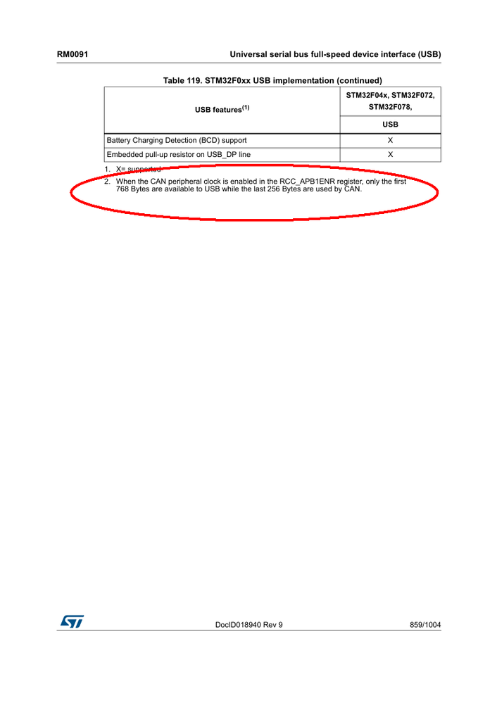

Is it possible to use CAN and USB on the STM32F042C6U6 at the same time? I know it's not possible on the stm32f1 but the stm32f0 series is a bit newer and supposedly this is possible on some of the newer chips. I wasn't able to find anything in the documentation

‎2020-03-11 2:16 AM
1 REPLY 1
Options
‎2020-03-11 2:16 AM
