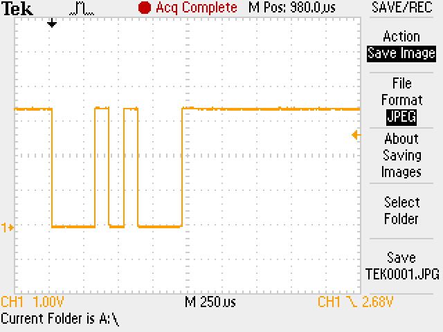

I also measured with the oscilloscope already on pin PA10 and I see the data package there.

If the transmitted packet looks right on the scope (can you post a screenshot?) then there's nothing to improve on the STM32 side.
Disconnect the serial adapter from the board, and connect its Rx and Tx pins together. Can you see the echo of what you are typing in the terminal?

I checked with the scope that data package see attachment. The value on the scope is 0x14 which is what I send.
Also when I bridged Tx and Rx on the FDTI cable. The reply was as it was supposed to be. Timing measured with the oscilloscope cursors was 100 microseconds per bit. I calculated 104 micro seconds for one bit for a baud rate of 9600.
