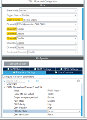

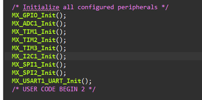

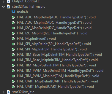

I just tried implementing what you suggested i.e. calling HAL_TIM_MspInit() but there is no sign of it in the generated code anywhere in the project. There are other MspInit() functions as you can see from the screenshot here but not that one.
The only functions generated by CubeMX are these:
I am new to STM32 so I am wondering if it could be because I am using CH1 and CH1N with TMR1 configured like in the screenshot below? The generated complementary PWM outputs are correct on the oscilloscope but perhaps I configured it incorrectly or in a less than ideal manner (although )? Maybe using different settings would generate the HAL_TIM_MspInit() you are referring to?  Or perhaps I need to #include some header?
Thank you again! :)
HAL_TIM_PWM_MspInit probably. Or maybe HAL_TIM_Base_MspInit
Whatever function the pins are initialized in.
Thank you
and really sorry about this but I have been looking at all those functions, but unless I am missing something, it does not appear the pins are initialised in any of them.
I am new to STM32, perhaps initialisation is there but in a form I don't recognise?
The PWM pin names are OUTPUT_PWM_2 and OUTPUT_PWM_1 on PA7 and PA8. But I don't see them addressed anywhere in any of the project files.
