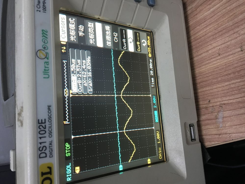

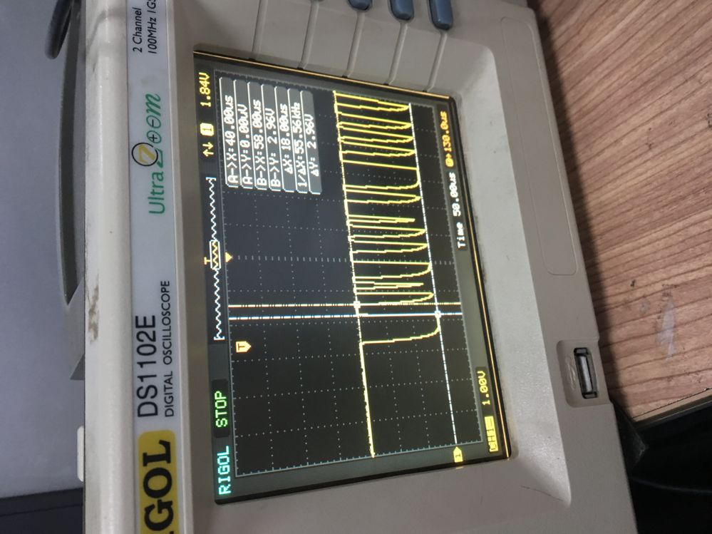

‎2019-07-17 8:41 PM
Which part of board should I check? Attach are my check for HSE and D+ frequncy with oscilloscope. Please have a check.
‎2019-07-17 9:06 PM
Do you have a crystal ?
‎2019-07-17 9:14 PM
can you check the USB specification ?
do you have a different board that does work ?
I never used that processor myself.
but the only time I had an issue was with the crystal... and cube configuration
please check your USB cable connections,
do you use the 27R resistors ?
did you use the ESD protection ?
did you check the ESD protection is correctly installed, may be better to pull it off...
I still think it is external to the processor.

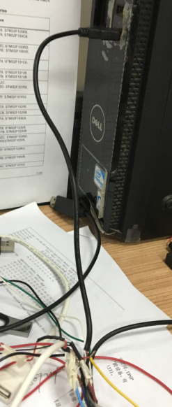

Please show the cables you are using to USB port.
I think you have cable fault.
You can prove it by restarting your Cube file from scratch, the Cube code works without modification

‎2019-07-18 6:28 PM
This is my used USB line. I use our product to do the function. USB D+/D-> device D-/D+, USB GND->device GND, USB power -> device VBUS.
