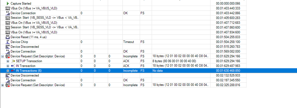

I have coded some usb code which is correctly sending and recieving data. The problem is that at the end of sending the device descriptor no STATUS_OUT packet is sent.
I've done the following to get the above sending:
- Copy the rx data from usb buffer (Packet Memory Area).
- Determine the recieved request is a Device request.
- Clear the CTR_RX flag.
- Write device descriptor to transmit section of usb buffer (PMA).
- Set STAT_TX to valid (by toggling with an XOR).
If I just to the above, this happens:

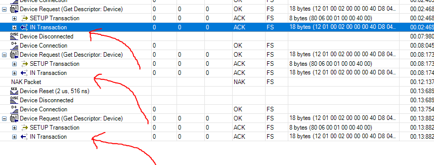

The above STAT_TX/IN transaction should result in a CTR_TX type CTR interrupt. Inside that handler I do the following:
- Clear the CTR_TX flag.
- Set STAT_RX/OUT to VALID, this should trigger the OUT transaction right?
Unfortunately it doesn't, does anybody have any ideas of what to check/try?
When I do the STAT_RX thing it does the following:
