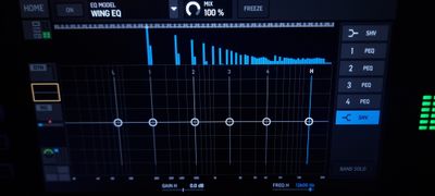

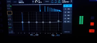

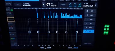

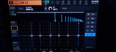

I did what you said with the Sawtooth at 2 frequencies. 200Hz and 1kHz. Strange behavior appears. On 1kHz it plays properly no matter how long I let the Sawtooth wave play. On 200Hz artifacts begin. I haven't found the frequency from which below it, artifacts start. I have Taken some pictures of the RTA so you can see yourself.
Below is the Proper 1kHz Sawtooth from my computer to the RTA (Audio Jack so I know it works):
Below is the SPDIF 1kHz which as I said (surprisingly) works properly on this frequency no matter how long I play the wave:
Below is the 200Hz that plays properly from the Audio Jack and I monitor the RTA:
Below is the 200Hz that plays from SPDIF, and as you can see as well, even from the first harmonic there is difference from what SHOULD be playing in comparison to the proper 200Hz I should be seeing on the RTA. The Loudness of each frequency is different and some artifacts start appearing very loud:
I see you also mentioned that I can use the USB SOF to sync the audio. Can you elaborate more on than as to how it should be done? I am thinking that when the SOF is received that's when I should start the DMA, but if that is the case, isn't that the same thing as to starting the DMA when PeriodicTC is called (which is called whenever an audio packet is received)

You should look at the waveform / time signal of the SPDIF result, maybe then you can see that there are some "jumps" in the signal every now and then.
And for this kind of signal analysis, I recommend an analyser with a) higher resolution, and b) a linear frequency x-axis .
1 kHz: maybe you don't see any glitches because it equals the USB iso freq.
Sync: it's not a matter of the DMA start or clock, rather the SPDIF audio clock should be synced with the USB SOF.
I think the F7 (or any other STM32) does not have such a feature, so it would be quite complex to sync these (something like: audio VCO counting SOF pulse output (I guess the F7 can do that?) via timer, then DAC output to VCO, ...).
