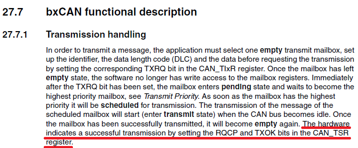

Please find below the approprite inputs for each point:
1. It is not sufficient to check the HW TX buffers for successful transmission, in fact RQCP and TXOK must be also checked please see below the underlined line taken from Reference Manual.
The check of the previous bits is done in __HAL_CAN_TRANSMIT_STATUS() within the stm32f4xx_hal_can.h file.
2. We understand that this is a limitation that some of you are experiencing, especially with COM IPs with FIFO, resulting the inability to launch many IT transmissions at the same time despite a FIFO is present to stock transmitted messages. We?ll pass it along to our STM32Cube team.
