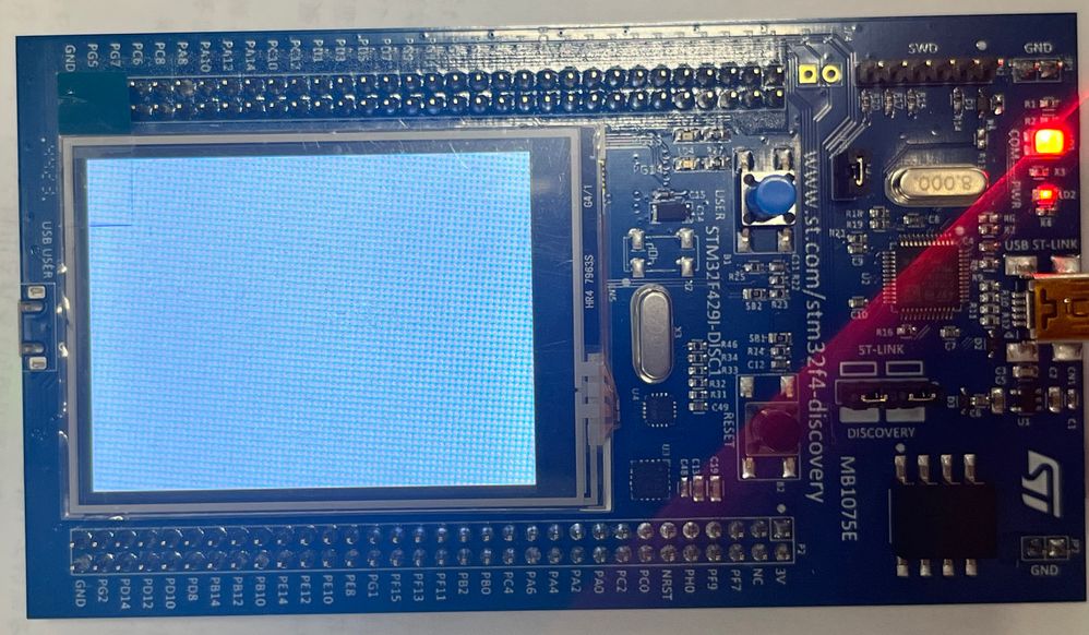

However, after powering on the board, the LCD remains completely white and nothing is displayed.

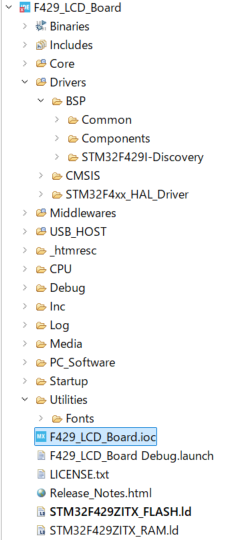

  • The folders Drivers/BSP/STM32F429I-Discovery and Utilities/Fonts are properly included in the project

  • The LCD backlight turns on, but the screen stays white all the time
