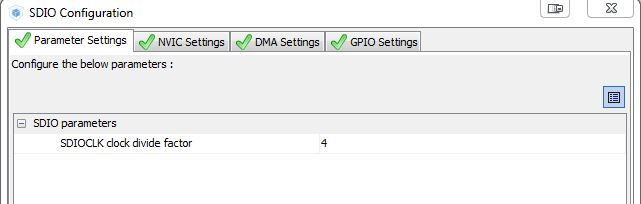

I am using generated code from CubeMX. Here you can specify the clock divider.: 0690X00000602ZbQAI.jpg The generated code looks like this:
void MX_SDIO_SD_Init(void){hsd.Instance = SDIO;hsd.Init.ClockEdge = SDIO_CLOCK_EDGE_RISING;hsd.Init.ClockBypass = SDIO_CLOCK_BYPASS_DISABLE;hsd.Init.ClockPowerSave = SDIO_CLOCK_POWER_SAVE_DISABLE;hsd.Init.BusWide = SDIO_BUS_WIDE_1B;hsd.Init.HardwareFlowControl = SDIO_HARDWARE_FLOW_CONTROL_DISABLE;hsd.Init.ClockDiv = 4;HAL_SD_Init(&hsd, &SDCardInfo);HAL_SD_WideBusOperation_Config(&hsd, SDIO_BUS_WIDE_4B);}
The problem is the WideBusConfiguration function which looks like this:
Init.ClockDiv = SDIO_TRANSFER_CLK_DIV; /* Configure SDIO peripheral interface */ SDIO_Init(hsd->Instance, Init);
It overwrites the clock divider field and thus the configuration will never be used. Thus I cannot use a different clock divider than ''0'' which results in (0+2) and is equal to 48MHz/2 = 24MHz that is hardly the specification limit. - Robert #hal #sd #!bug

Hi Robert,
Could you please specify which STM32 product you use and with witch CUBEMX version you interface the issue.
-Syrine-

Hi Syrine,
I am using an STM32F207VCT with altest versions of CubeMX and the HAL. It looks like this is not a problem with the processor but with the HAL actually.

Hi robert,
Thank you for your feedback. The issue is reported internally.

Hi robert
Thanks for reporting this bug, it was fixed since the 1.2.0 version of the STM32F2 cube firmware package.
