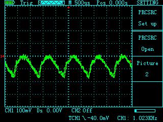

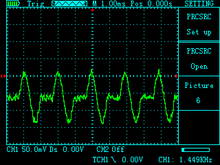

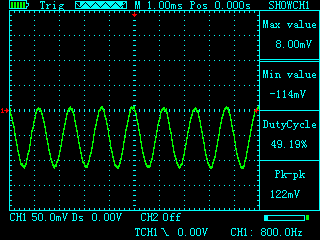

I am programming an SMT32F69I-DISCO board to output a SINE wave. I am having trouble with the Size parameter of the BSP_AUDIO_OUT_Play() function. I have a buffer of 100 that I am filling with my SINE values:
int16_t dataI2S[100];
Here are my calls of the functions to initialize and play audio @48 KHz:
BSP_AUDIO_OUT_Init(OUTPUT_DEVICE_BOTH, 80, 48);
BSP_AUDIO_OUT_Play(dataI2S, (uint32_t)200);
Here is what it looks like when I put 128 as the Size parameter:
0693W00000GYZcRQAX.bmpWhen I set it to 100:
0693W00000GYZdKQAX.bmpWhen I set to 200:
According to the function definition I put below, it sounds like it should be set to 200 because it's the size in bytes.

The period is consistent for each data length. How do you know the data you're sending isn't what is displayed? How are you initializing the array?
Kneepatch
Senior
Yes, it seems that I only have 64 values in my array, not 100! Can't believe I did not catch that. Thank you!
