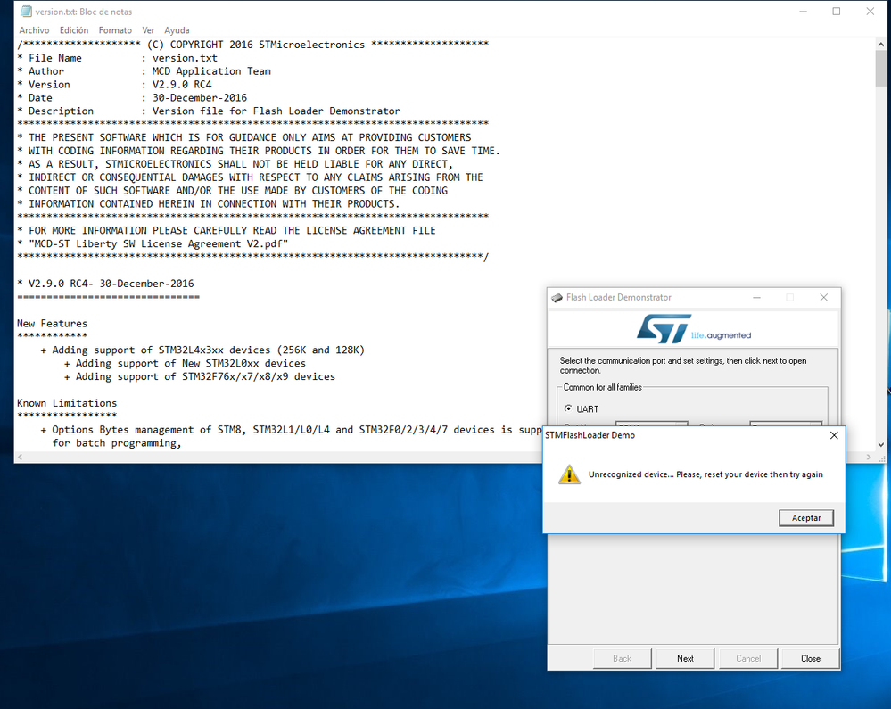

I tried to program a STM32L031C6T MCU using bootloader through USART2. I use STMFlashLoader application and Cisco USB to RJ45 (p8) cable. This cable uses a FT231X chip and I have it´s driver installed.

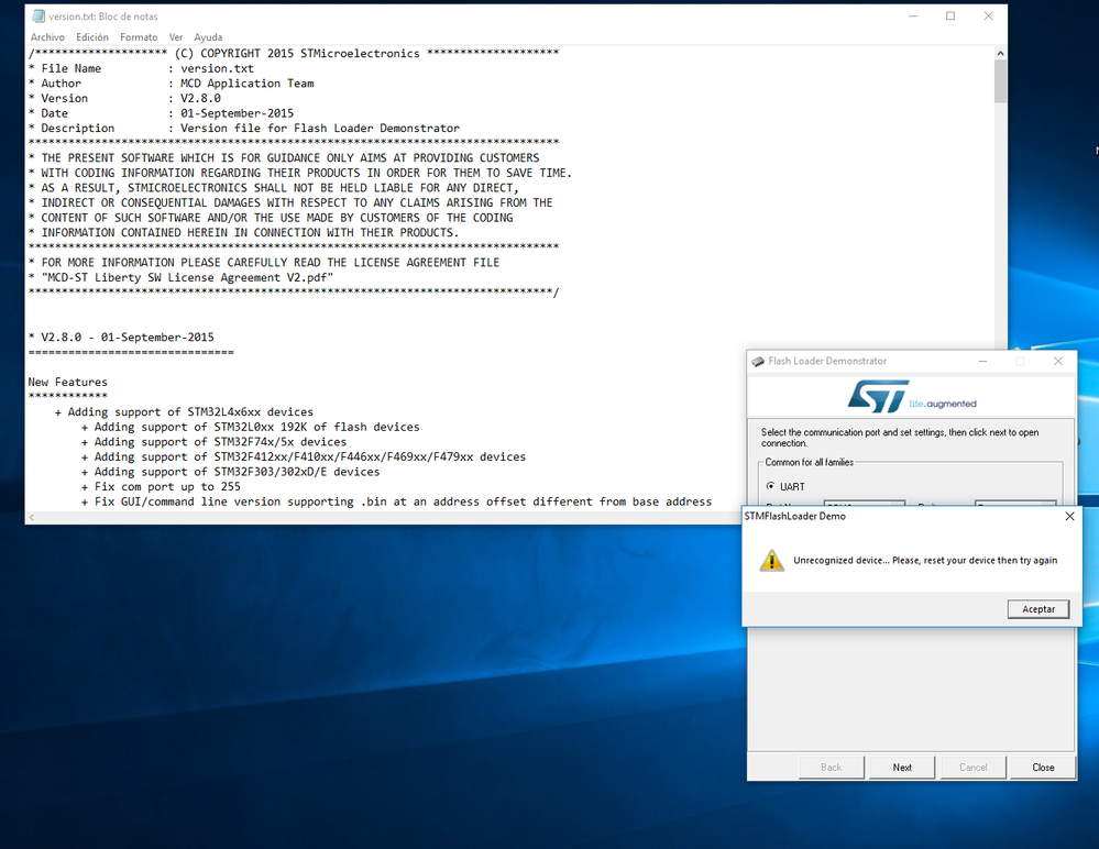

My problem is that the connection it´s working, it says: "unrecognized device... please reset your device and try again".
To enter in bootloader mode I need to put "1" on BOOT0 pin and nBOOT1 bit must be also "1". By default nBOOT1 is "1" so I only need to put "1" on BOOT0 pin during reset. I know my MCU is not running my code (and also message from STMFlashLoader is different)
so it only can be in bootloader mode or running from embedded RAM. But as I said before nBOOT1 bit is "1" by default and I didn´t touch this, so it must be in bootloader mode.
I've searched for info and find this page: http://www.emcu.eu/2017/11/10/flash-loader/ that says: "ATTENTION. Up to now, 10-November-2017, there is a problem to program the STM32L0x1/2/3(32KFlash) using the standard Flash Loader (ver.2.8.0) present on the STM Internet site. If you had the necessity to program the STM32L0x1/2/3 download this release(ver.2.9.0) of the Flash Loader and use it." I downloaded this new version but the same issue.

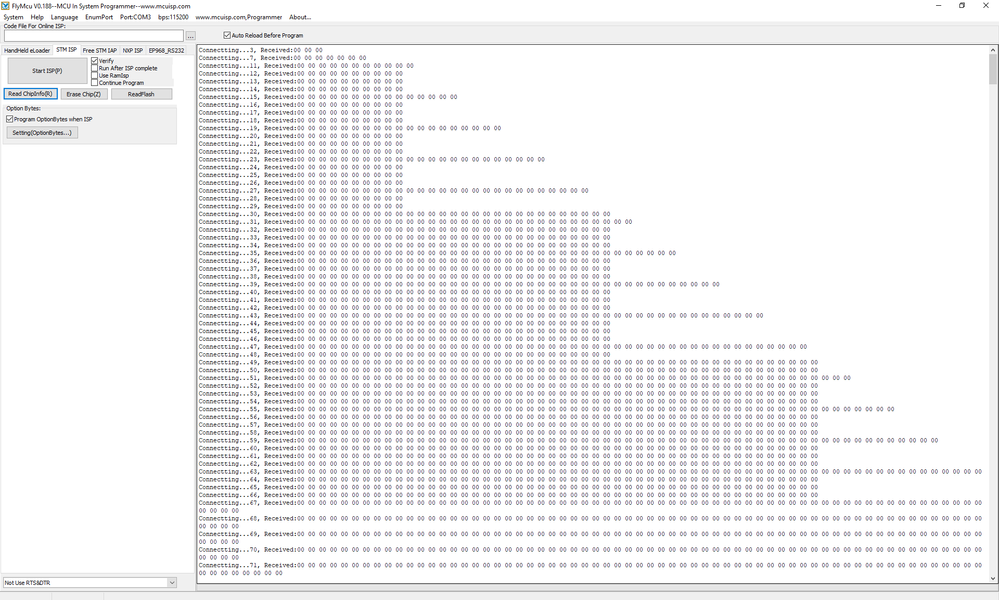

I find another app that also program flash using STM32 bootloader, FlyMCU v0.188 and it also can´t connect and if I try to get ChipInfo my MCU answer with all "0x00". I read STM32 bootloader and it says MCU waits to receive "0x7F" and answer with an ACK (0x79) or a NACK (0x1F) so it seems that this cable is not working properly because it seem it answer all with 0x00. I tried it with my 2 prototypes but result is the same.

I used HTerm app and I saw the same result, I send 0x7F (1byte) and receive 0x0000 (2bytes).

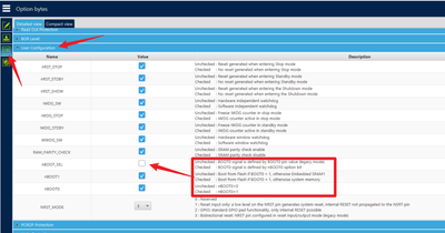

2024-12-02 4:54 AM
I have the same problem and finally find the solution.
1. Open STM32CubeProg
2. Connect to the board with ST-Link and SWD port
3. Navigate to Option bytes panel
4. Extract User Configuration list
5. Uncheck nBoot_SEL
You can read the descriptions to the right, and they explains everything.
I'm very annoyed that ST never make this clear in their documents.
