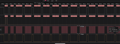

 2. Assuming the above actions enabled the boot up from system memory in STM32L031xx, once I try to send SPI data from swift (in house chip – this is the Master SPI), I don’t get back any acknowledgement from the STM bootloader side. As per AN4286, we need to send the synchronization byte 0x5A, and wait for the acknowledgement byte 0x79.
I never receive the acknowledgement. I am attaching a screenshot of salae logic analyzer.

What is missing in the implementation?
Is there more information on the SPI Slave of the System Bootloader, what is the clock polarity and phase set for SPI?
FYI, the SPI communication of the STM32L031xx firmware working as slave is successful with swift, I have verified that. In firmware I have set the Clock Polarity as High and Phase as 2Edge.
Is there any code for firmware upgrade using STM system bootloader available for reference both from master and slave end?
What are the configurations of the GPIOs in system bootloader mode?

Senior II
Since this chip support booting via uart, it's easy to verify the boot from uart using usb to ttl converter. Use CubeProgrammer. It has option to boot via uart. Disconnect all devices connected to other uarts and spi ports to ensure that all false trigger are removed. Once you are sure of the sequence you can boot via spi, remove all uart connections and try
