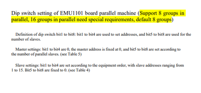

CORRECT address as se the DIP switch. Make sure that you send the command bytes correctly, Check sum and Length etc. While sending keep DE/RE to  1 so that transmission happens and immediately switch over to 0 for the unit to respond. Receive till 0x0D

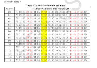

eg of query command from the datasheet

Do you know how to manually set the address? For example, I manually keep the address positions at zero and send the command based on the address value 00.

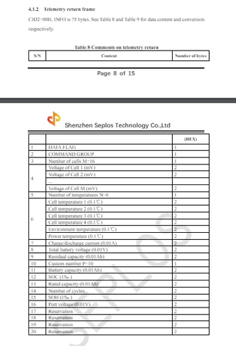

As far as I understand, the STM sends commands based on the data in Table 7. For example, after sending the telemetry data at address 00 in Table 7, we should automatically receive the parameters such as cell voltages and cell temperatures listed in Table 8, right? My main question is, if I need to store the temperature and voltage parameters from Table 8 into specific arrays, those bits should correspond to the temperature and voltage values we need. However, it is not specified in Table 8 which bytes the temperature and voltage data should be stored in. In this case, do you think my void SeplosBms_Read(); function is written correctly? Do you see any other errors in the code?
How many devices are there? you need to know the address. earlier you made a statement that transmit is success, does it mean that when you send data, any parameter gets changed in the target device?

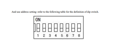

I am not familiar with your system. There must be some way to set the address by some dip switches. You need to know the set address.

Table 8 seems clear in the sense that the how many bytes are needed for each parameters, you need to count it as per the table, first read the number of cells and based on that you can count from the start of the frame. Looks like if you read the document multiple times and  analyze you can do it.

There is some information about addressing that I will send to you as shown in the image below. As far as I understand, if you have more than one slave device and need to establish a master-slave connection, you may need to change the positions on the DIP switch. But since the STM is a master device and the battery management system is also a master device, I believe the positions should remain at value 0.
My thought about Table 8 is that it provides the necessary information about the number of bytes and how much space to allocate, but it does not give complete information on which parameter to store, for example, in the 15th byte. In this case, I made a logical inference and created the SeplosBms_Read() function accordingly, but I am not sure if it is correct
