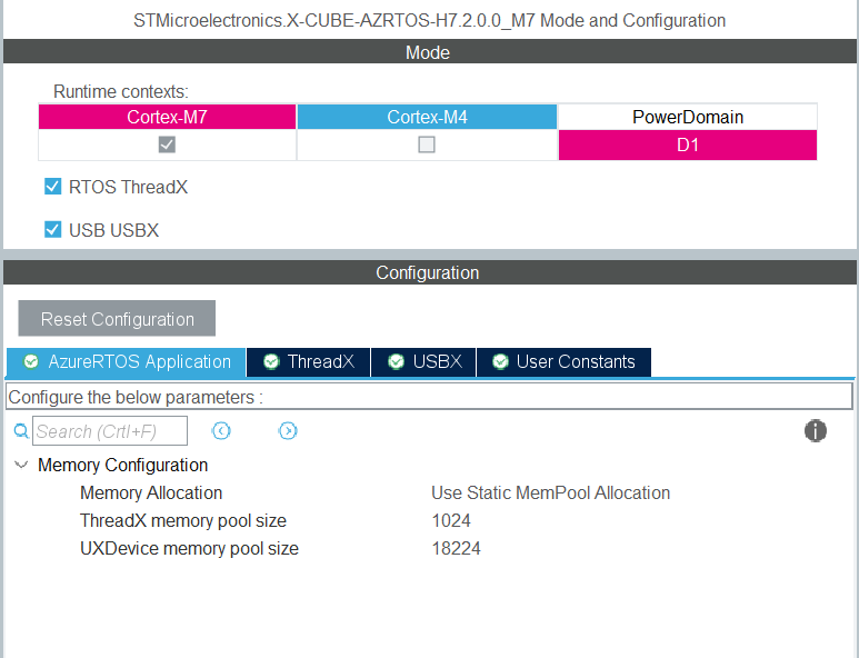

I am working on nicleo-h745ziq board according to this video https://youtu.be/wCRIpp-OHY4 i follow the steps biut USB is not get detected why? also I create project for Ux_Device_CDC_device but also in this example usb detection is failed why this happend? i try simple USB CDC as virtual comport is works fine can you please help there is any support for only AZURE RTOS

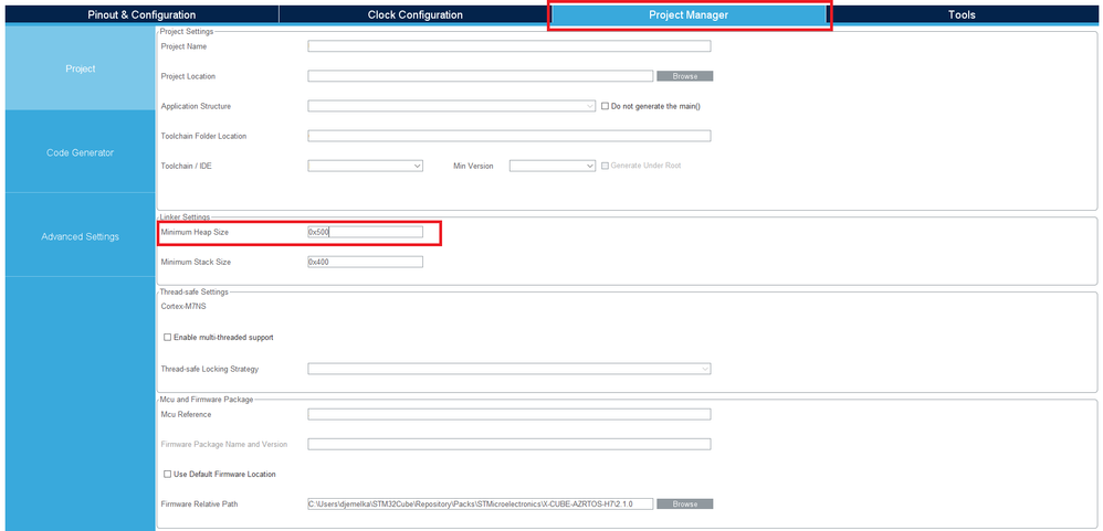

Try to increase the heap size, This may solve your problem.

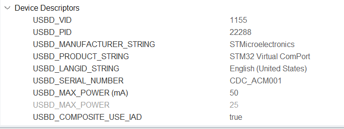

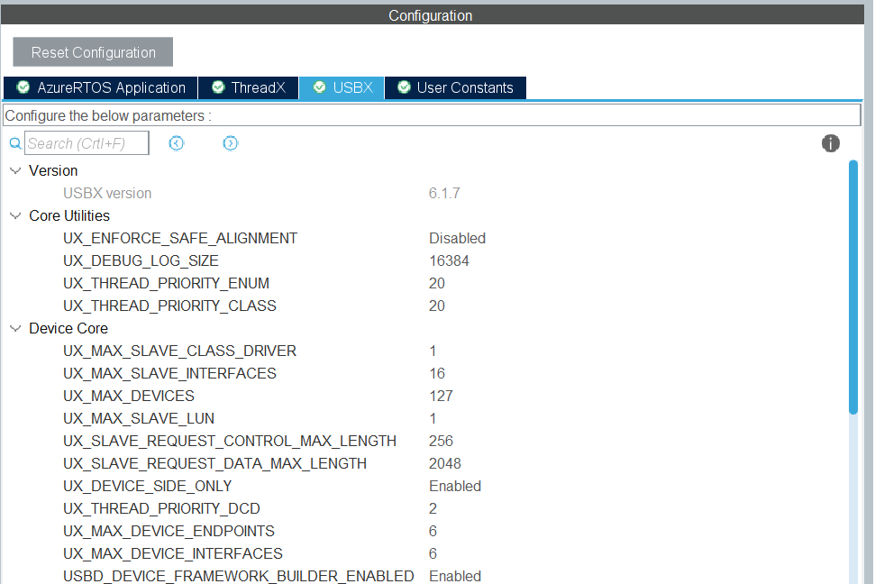

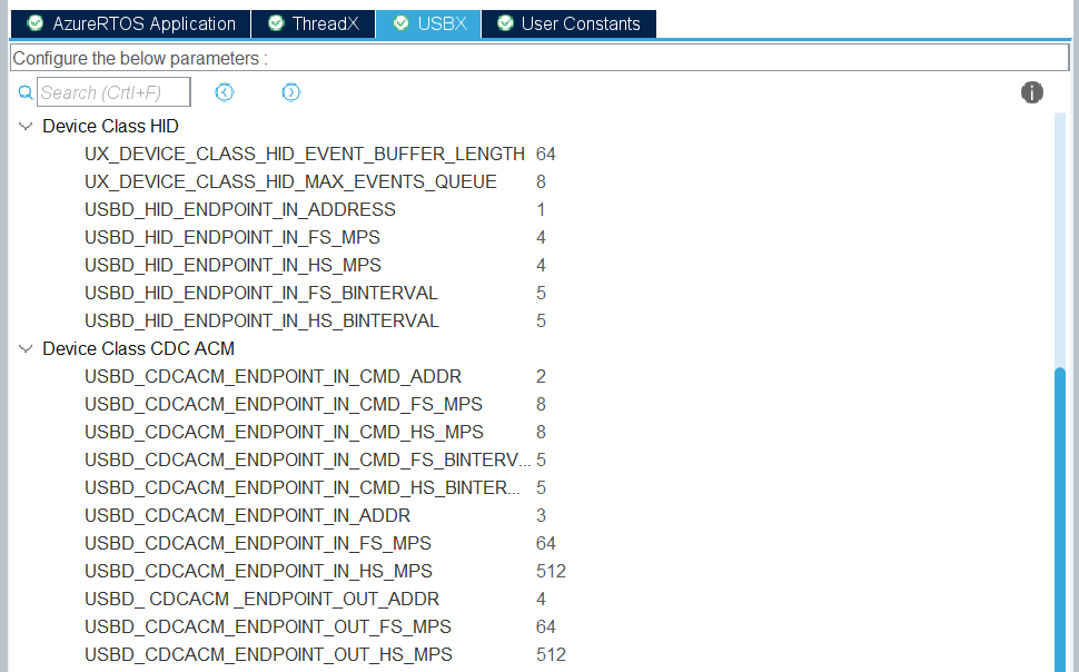

I make these following configuration this is right or wrong ,which paramter i have to change?

You can change the heap size in the project manager to 0x500 as shown in the below figure.Kaouthar

@MDeva.1 ​Could you please verify your endpoint config?
