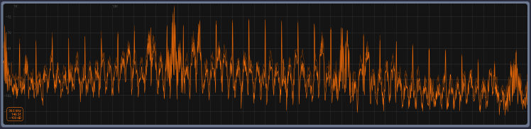

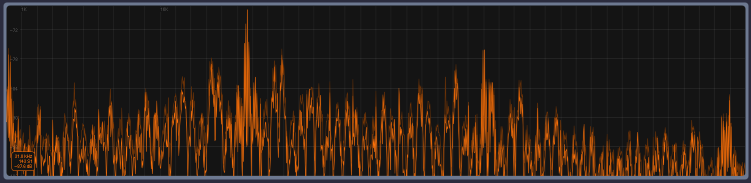

Hi! I am using STM405RGT6 and TI PCM3060 audio codec. I use DMA to RX and TX I2S data. I2S configured to 96000 Hz.
When I set buffer size, for example, 64 samples I get parasitic frequency peaks at every 1,5 kHz (96000/64 = 1500) - 1.5 kHz, 3 kHz, 4.5 kHz... If I set buffer size 256 samples I get parasitic frequency peaks at every 375 Hz and so on. Level of this noise is about -60 dB. I am just send recieved data back to codec, not using any processing.How can I remove this noise? #dma #i2s #noise #audio- Mark as New
‎2015-04-13 1:10 AM
update:
Maybe it will help to recognize the reason of the noise: If I set DMA_PeripheralBurst to ''DMA_PeripheralBurst_INC16'' instead of ''DMA_PeripheralBurst_Single'' noise peaks becomes lower by 10 dB.
I was wrong. Even if I send zeroes to codec (checked with oscilloscope) I hear noise.- Mark as New
‎2015-04-13 5:11 AM
Sounds like digital leaking into analog. I would review the grounding and supplies first.
JW- Mark as New
‎2015-04-21 4:55 AM
Thank you for your answer!
I checked all grounds and didn't find any 1,5 kHz noise. But I noticed if I set ''Enable LTO'' in linker options the noise dissapears and if I uncheck this option it appears again. Disable LTO:void

‎2015-04-22 8:09 AM
I found an error in lines
DMA_InitStructure.DMA_PeripheralDataSize = DMA_PeripheralDataSize_HalfWord;
DMA_InitStructure.DMA_MemoryDataSize = DMA_PeripheralDataSize_Byte; It should beDMA_InitStructure.DMA_PeripheralDataSize = DMA_PeripheralDataSize_HalfWord;
DMA_InitStructure.DMA_MemoryDataSize = DMA_MemoryDataSize_Byte; I tried to enable FIFO, to change memory data size, to set periph or memory bursts.. I tried to start DMA RX stream before TX stream and vice versa but it doesn't help. I really stuck.- Mark as New
