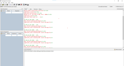

However, I am facing an issue:
- When I first call the udpClient_connect function from the main function and attempt to send data using the udp_send function, it returns an error code -4.
- After the first attempt, subsequent calls to udp_send do not return errors, and the function executes successfully.
- I am sending data at 1-second intervals, but I am unable to see the data on the Hercules tool.
Here is screenshot of the debug log printed on Docklight.
I have attached my project for your reference.
Could you please help me understand why the initial error occurs and why data is not visible in the Hercules tool?

Hi @STea ,
Thank you for your support! I have resolved the issue. The problem was on the hardware side of the STM32H7S78-DK Discovery board. To enable Ethernet functionality, modifications were required in the default solder bridge configuration:
  • PC1 needed to be closed.
  • PB2 needed to be open.
These adjustments resolved the issue successfully.
