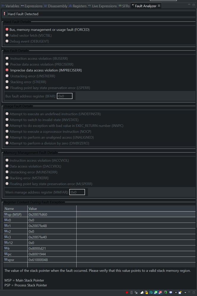

I've a NUCLEO-F767ZI. I'm having problem getting the arm_fir_q15() to work, it gives me a hard fault. I'm defining the variables like this:
#define BLOCK_SIZE 1
#define NUM_TAPS   51

uint32_t blockSize = BLOCK_SIZE;
arm_fir_instance_q15 S;
static q15_t firStateQ15[BLOCK_SIZE + NUM_TAPS - 1];

After calling arm_fir_init_q15(&S, NUM_TAPS, (q15_t *)firCoeffs, (q15_t *)firStateQ15, blockSize) and the rest of the HAL stuff in the main() function, it proceeds to the DMA interrupt where the data is processed:
void ADC_DMA_Callback(void)
	char AsciiData[16] = {0};
	float sin = 0;
	q15_t sinQ15 = 0;
	static float filtSin = 0;
	q15_t filtSinQ15 = 0;
	for(uint8_t i = 0; i < 8; i++)
		sin += g_AdcReading[i];
	sin /= 8;
	sin *= 8.05861e-4;
	arm_float_to_q15(&sin, &sinQ15, blockSize);
	arm_fir_q15(&S, &sinQ15, &filtSinQ15, blockSize);
	arm_q15_to_float(&filtSinQ15, &filtSin, blockSize);
	snprintf(AsciiData, sizeof AsciiData, "%.2f,%.2f\n", sin, filtSin);
	HAL_UART_Transmit(&huart3, (uint8_t *)AsciiData, strlen(AsciiData), 1);
The problem I'm having is that after the call to arm_fir_q15() the system goes to the hard fault loop, giving me this:
If I use arm_fir_f32() with the appropriate float variables, coefficients, etc., it does function normally. What might be causing this hard fault?
