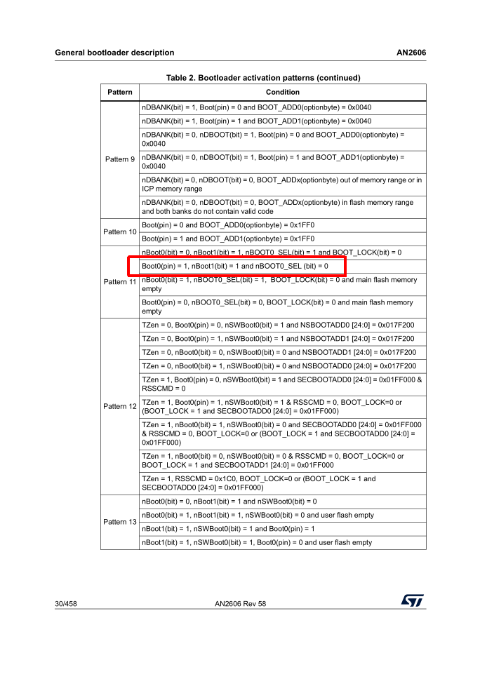

AN2606 Pattern 11 ('G0, 'C0) and BOOT_LOCK
‎2023-05-07 2:15 AM - edited ‎2023-11-20 6:12 AM

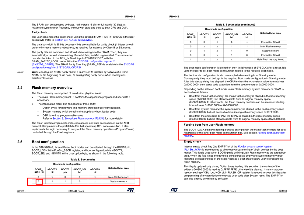

AN2606 in description of Pattern 11 entry combination appears to indicate, that there's one combination when BOOT_LOCK option bit is ignored:
However, this contradicts the RM:
Can ST please clarify.

‎2023-05-08 10:17 AM
Hello @Community member​,
Thank you for sharing this point.
This is an issue on the AN2606, and I escalated this internally for correction.
An internal ticket ID 151513 is submitted in order to correct the AN2606.
(PS: ID 151513 only for reference, not available outside of ST)
Thanks
