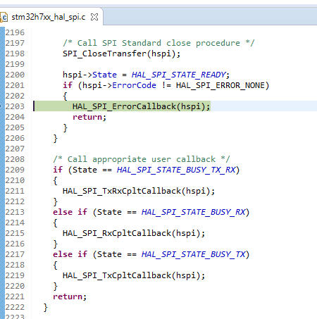

Expecting following function to be called (see Figure-5)

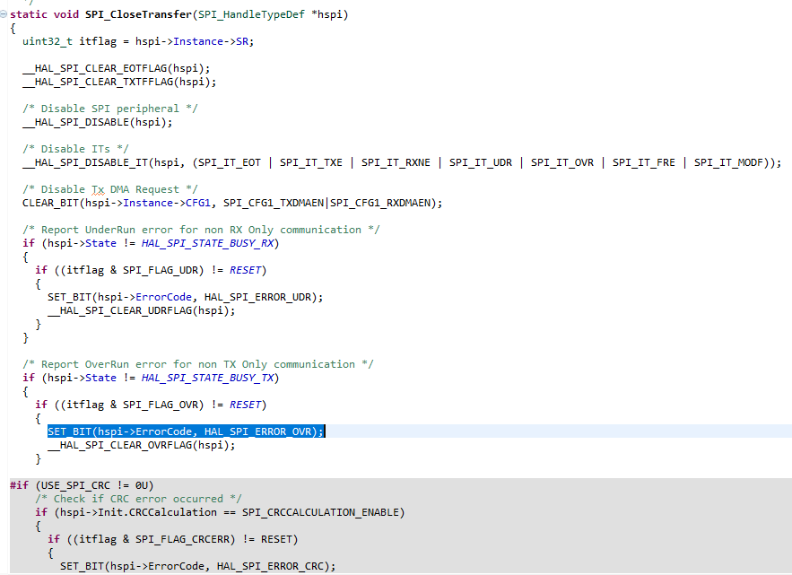

But always getting SPI_ERROR_OVR (see Figure-6)
Figure-6
This will eventually calls HAL_SPI_ErrorCallback(hspi) and return instead of HAL_SPI_RxCpltCallback(hspi)
Figure-7
Same experiment works well with STM32F7 but always getting OVER RUN Error in STM32H7.
Means Configuring SPI peripheral to SPI1, using DMA1 and reading data in normal mode, eventually generates the both HT & CT interrupts for DMA, but in CT it always generates the SPI OVER RUN error instead of calling
How to resolve this issue, Guys please help.

Please don't ping me privately about posts on the forum.
I can't help you with CubeMX/HAL defects.
Make sure the buffer is in fact at the address ranges expected. Check what status/errors the DMA unit is reporting.
Check the lengths or transfer units are consistent.
If the DMA is placed in circular mode does it cause errors then? If not points to inconsistent size expectations in transfer.
Check appropriateness of FIFO settings.
Check for off-by-one issues of TX vs RX
