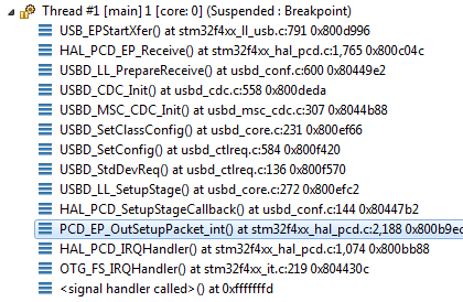

  * This is the call flow: https://peter-ftp.co.uk/screenshots/202209065715674317.jpg
  * Data is then copied into our circular buffer cdc_receive_buffer[1024].
  * No more data can be sent by PC until USBD_CDC_ReceivePacket gets called.
