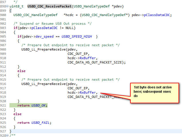

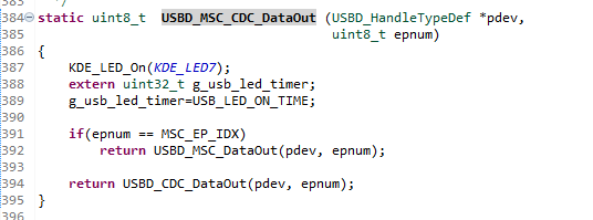

I am using USB for both MSC (removable drive) and CDC (virtual COM port).
MSC works perfectly.
CDC out has been working perfectly for ~2 years.
CDC in had never really been tested, and ~ 1 byte every 20 is corrupted.
I am running CDC to Teraterm on the PC, and the out mode has been used for debugs.
The in mode gets activated of you press keys on the keyboard.
I have a simple RTOS task which copies in data to output. That is where I see the corruption.
It is entirely fixable by disabling certain RTOS tasks! But the ones which "fix" it don't do anything related to USB. I am thus suspecting there is a critical region which is unprotected and RTOS related task switching messes it up.
These functions should be well known because it is generated by Cube MX. I don't use MX (the code generated tends to work but is bloated junk and often works by luck because the cloated code covers up timing issues) but it was used when this project was being created ~ 3 years ago by someone else.

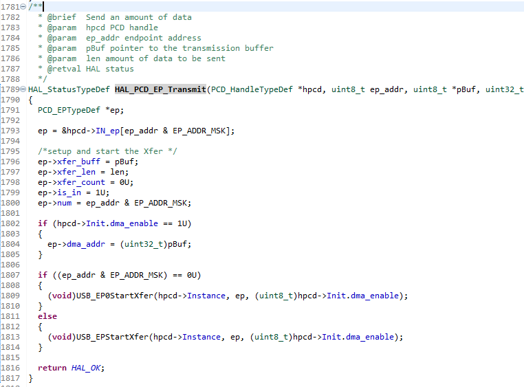

Tracing the TX code it indeed looks like the TX path just sets up some memory values, and does not do any obvious hardware interaction, so something is monitoring those values (struct members) and kicks off the TX.
It is like ETH, where the 32F4 ETH controller is continually monitoring some pointers in a linked list of packets, to see if any new ones have been left there. I spent a whole load of time there too but that now seems to be all working fine. (Actually I have some questions on that which I will post separately).
The TX path is
CDC_Transmit_FS
USBD_CDC_TransmitPacket
USBD_LL_Transmit
HAL_PCD_EP_Transmit
and in there, just some hpcd-> value gets set
so "something else" is monitoring the memory. And presumably enabling the interrupt you mention.

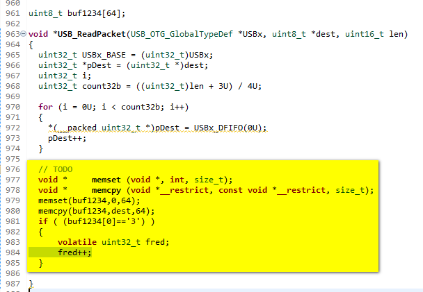

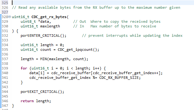

The 1st keystroke, always corrupted in CDC_get_rx_bytes, is delivered correctly into fred1234[0] here. I trigger the breakpoint, line 984, with "3" on the terminal, and this enables it to isolate the issue
This is CDC_get_rx_bytes:
It is all the stuff in between where I struggle to find the data. Various buffers get passed by address.

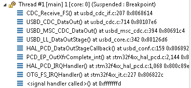

AFAICT the data (the byte, and count=1) is right oin here (called from an ISR) and USBD_CDC_DataOut returns the right data also.
PHolt.1
Senior III

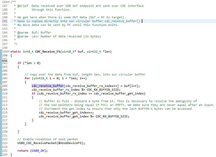

OK, found it and fixed it. It was junk in CDC_Receive_FS().
Various junk, but most notably it was enabling reception of next packet before reading out the previous one. Most of the time this would work (and did) unless the RTOS got in just at the wrong point and delayed things just long enough.
Final code:
One ISR loads data into a 64 byte linear buffer and another ISR calls (eventually) CDC_Receive_FS() where in the above example this buffer gets copied into a 1024 byte circular buffer. This is the flow:

CDC_Receive_FS() is apparently your code. If it originated from CubeMX-generated, it would be interesting to see what exactly did CubeMX generate.
