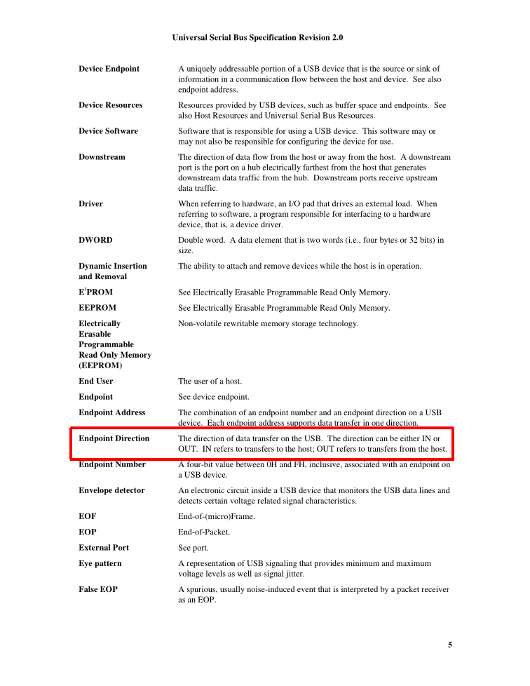

> I am running CDC to Teraterm on the PC, and the out mode has been used for debugs.
I am not interested in Cube nor RTOS, but you probably have the terminology wrong - USB is Host-centric:
0693W00000SuDXCQA3.pngJW

Sure; I had it backwards. The corruption is on the PC -> target direction.

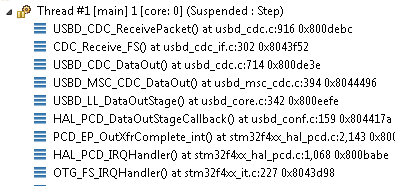

Not possible for me to debug this. This is the chain involved just in receiving the first (corrupted) byte, and nothing is documented:
waclawek.jan
August 31, 2022
The Cube USB Device driver is documented in UM1734. Of course raw Cube functions are documented in your Cube's UM, I am lazy to look up its number. And some of those functions are even yours, even if you don't think of them as such (e.g. HAL_PCD_DataOutStageCallback()).
Most of those functions do nothing, but increment a counter and pass a pointer. As you appear to catch the error at the end of the chain, you may want to instrument all functions in that chain to leave a trace.

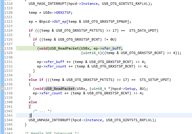

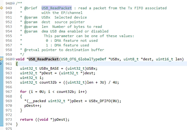

-- the OTG hardware is complex. One of the things it does is, that it first throws interrupt where software is supposed to pull data out of its FIFO, and then it throws interrupt which means "all data pulled, now act upon it". The reason is the existence of embedded DMA in the OTG module even if it's not present in its OTG_FS incarnation, I am not going into details here. What you've posted above is consequence of the second interrupt, but if there are invalid data for any reason, its read in the first interrupt. Look for USB_ReadPacket() (unless it changed from what I've analysed, CubeF4 v1.21). You definitively need to instrument it to be able to debug this, as all data for all endpoints go through that function. Luckily you deal with one very particular endpoint so that's your starting point.

This is the function
I can see this reads the (64 byte?) USB FIFO into a buffer. However, it is getting called all the time, possibly because it does both MSC and CDC, and Windows is polling the MSC device at about 1Hz all the time.

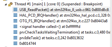

This is the debug stack before the breakpoint gets hit
0693W00000SuGEmQAN.pngThere are only two lines in the project where usb read packet is called and this shows line 1328
0693W00000SuGFfQAN.png I will try to get the content of that buffer when the corrupt data is seen.

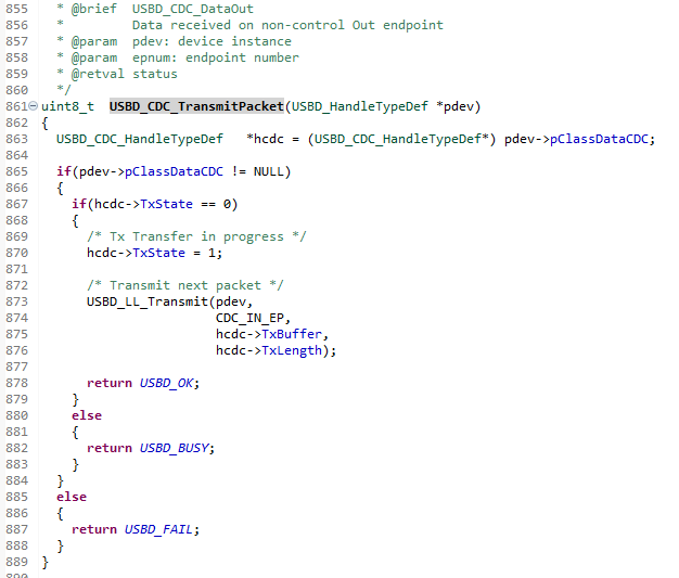

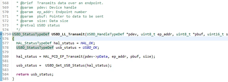

So I went to look whether one can disable interrupts during output (either USB, or all using the "critical" macro). This is the function used to transmit
and USBD_LL_Transmit is not easy because it is called constantly by MSC
0693W00000SuI4KQAV.pngI think if I put in code in this one which I can breakpoint on if it gets called with a non MSC packet, that might do it, but I don't know how.

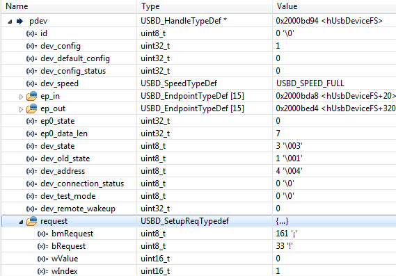

This is pdev for MSC:
0693W00000SuI4yQAF.pngI suspect the id=0 refers to the single USB port.
I managed to get a breakpoint on size=1 (unlikely with MSC, but can happen) but the stack trace sequence is again very long and appears to be interrupt-driven, even for TX.
Anyway I tried some simple things, like a flag in USB_ReadPacket (which reads the FIFO) which is set around that, and waiting on that flag in USB_WritePacket, but that doesn't help.
I wonder if that ST code was ever supposed to work in both directions? In my test code the two paths may be occuring very close in time, so I put in a 100ms delay, but it doesn't help.
Fortunately USB VCP input is not a core feature of the product (output is, for debugs) so I am ok to abandon it. There is one place I want to use it (selecting factory test menus) but there I can just dump non ascii chars, and most of the corrupted chars are in that category. Also the % corruption is highly sensitive to what other tasks are running, especially SPI3 DMA, and most of these are not needed during factory test.
