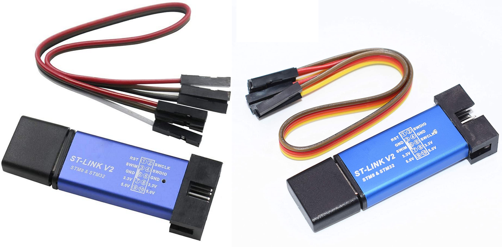

Also, more expensive models (including the standalone ST-Link/V2) support & auto-detect a range of target voltages - but I've only seen Chinese clones fixed at 3.3V.
Another thing is that there's no standard pinout, and it does vary!! :o
So, if you've got more than one, it's possible that they have different pinouts - which could cause damage...
Here's an example - look carefully at the pinout legends on these two:
