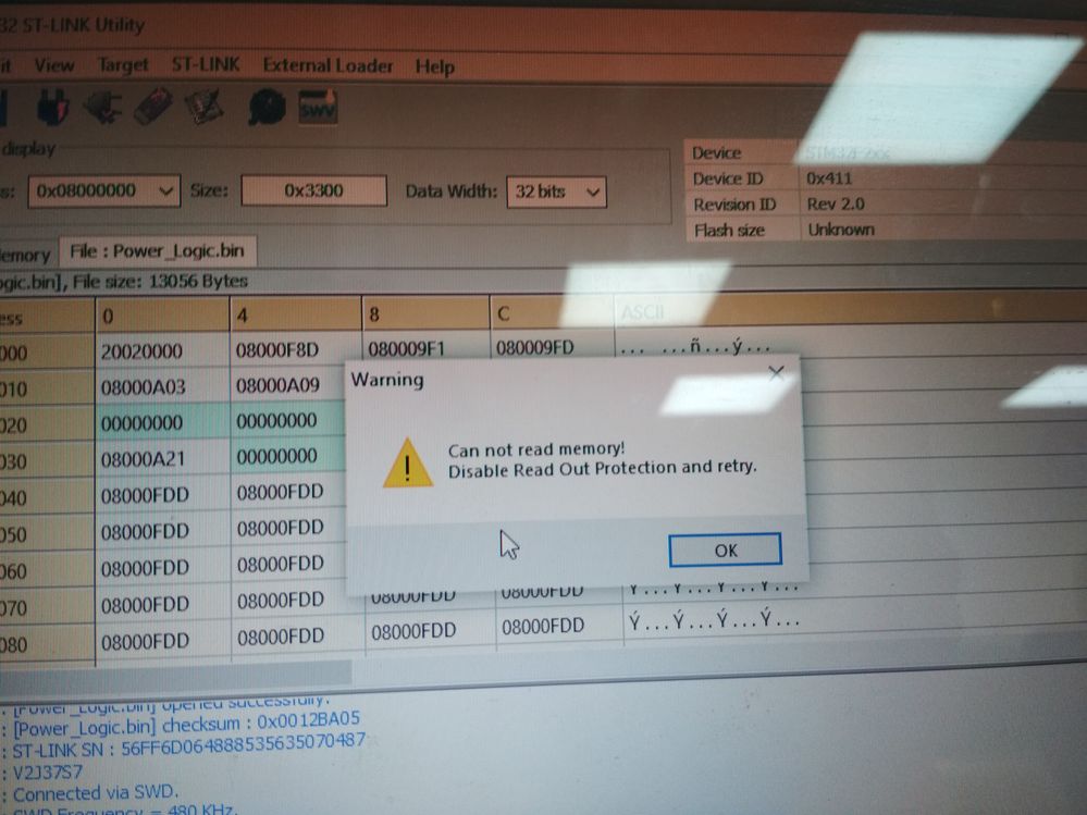

why i am getting DISABLED Read out protection error? I didnt changed anything.I can not reprogram my stm32f207 custom board .How to resolve thisissue?

The warning messages says it can't read memory because RDP is enabled. Disabling RDP can be done within the option bytes (Target -> Option Bytes). Set it to level 0 and restart.
hello, thanks TDK ,for your time and reply. I tried doing it with stm utility but I am unable to modify it.it shows same warning again. Any help would be great.

I checked from my side and I have no problem, it works for me.
It's strange that you have the Flash size: Unknown !
As you see in the below screenshot, the flash size is 1MBytes.
0693W000006Hyo4QAC.pngSo, please check that you have the correct dev ID, rev ID, flash size from the reference manual.
