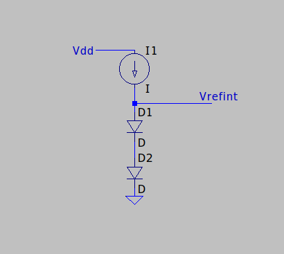

Regarding schematic, my guess is, it's build the same way as TL431. Exact topology likely proprietor, and would never be published. Same as topology of the adc, dac, opa or comp, those analog peripherals have specification but very little details on the internal whereabouts.
S.Ma
Principal
Wikipedia on bandgap voltage. Structure which relies on process rather than supply voltage, temperature, etc... This way, vdd ran be deducted from vref adc measurement.
AScha.3
about this is there on chip:
