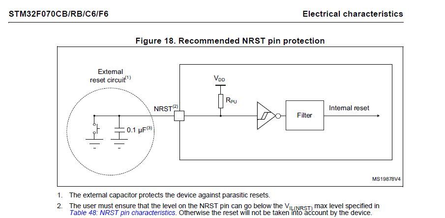

Also NRST pin is pulled up "strongly" while is already pulled up with 40Kohm Additionally is not connected in the same +3V3A rail but to the other side of MCU jumper.

  2. Also NRST pin is pulled up "strongly" while is already pulled up with 40Kohm - I tried removing Pullup resistor but it does not make any changes.

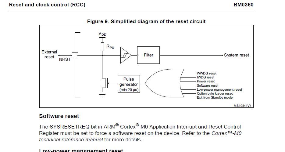

NRST pin is also an output pin. it can be driven Low from an internal reset source. So check reset flags of clock controller's CSR register just after this described reset to find the reason of unexpected reset.0690X000008BQWmQAO.jpg
