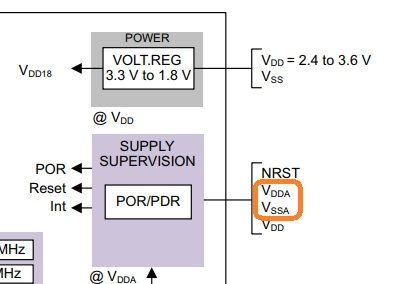

So an issue probably with how you are powering the device, most likely VDDA.
Sorry entirely unfamiliar with your design.

Ok, but you're question suggests the part is dead in the water, right? You've haven't managed to talk to it or download anything on it?
Here's a picture illustrating my concern
