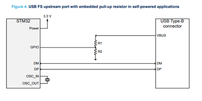

Based on the USB specification, a USB device must use VBUS sensing detection. When host connection is detected by the device, device connects pull-up resistor either to D+ or to D- data signal, allowing host to detect device presence on the bus.
1. Solution with a dedicated VBUS pin (PA9)
In order to reduce the voltage on PA9 below 4V, the usage of a voltage divider is recommended, so that AMR cannot be violated.
Recommended resistor bridge is "vbus-- R1=4.7k -- R2=10k -- gnd" and then VBUS detection (PA9) can be taken between R1 and R2.
2. Solution without usage of a dedicated VBUS pin
Any 5V tolerant pin with external interrupt functionality can be used with an external resistor divider, to fulfill AMR conditions. In this case, recommended values are 2x100 kOhms .
However the disadvantage of this solution is that the software handling of VBUS presence event needs to be implemented by the customer, since this is not managed within our STM32 USB library for the time being.
It is recommended to use a physical pull-up resistor.
For more information about how VBUS sensing shall be managed, I recommend you to take a look to Management of VBUS sensing for USB device design FAQ.

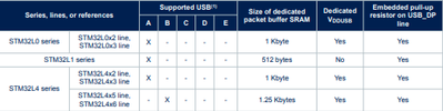

As per this documentation, STM32L476 support the interface B: USB 2.0 OTG_FS, that is, USB 2.0 FS device/host/OTG controller with on-chip FS PHY
and it had an embedded pull-up resistor on USB-DP line.
and the connection as per the documentation should be as the following:
In my case, the stm32 is self powered so I have no connection between the VBUS and the stm32 power. But I don't have the resistor bridge, VBUS isn't connected to anything.
In section 3.1.1, for self powered applications, "It is recommended to implement a resistor bridge (refer to Section 2.6 for more details)". However, in section 2.6, "Based on the USB specification, a USB device must use VBUS sensing detection. When the device detects the host presence, it connects its pull-up resistor to either a D+ or D- data signal. This allows the host to detect the device presence on the bus.The device is self-powered. VBUS sensing is mandatory."
I do have a pin not used next to PIN PA9 (VBUS_OTG_FS_VBUS) which is the USB voltage sensing pin, what I'm thinking about is to weld this pin to the PA9, put it as an output to power the PA9. In this way, the pull-up resistors are always connected or I can manage to power it in the software when I need it.
