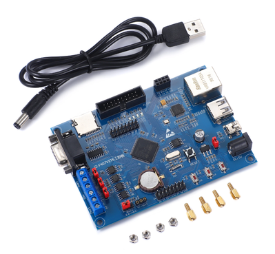

I have 3 of these (chinese origin) boards, 2 are failing communication, 1 is ok.
In essence my STLINK-V3SET fails to connect to the board but the led's on the brand new board are blinking. Therefore the MCU processor is running. I measured the 3.3V power supply pins on my STLINK and they are not powering the board (board is powered externally), so a 3.3 conflict does not seem to be the origin of the broken board, my question: are there any other steps that can be taken to repair the JLINK interface or at least find the origin of the problem?

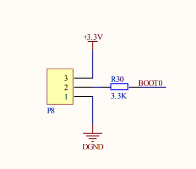

we don't know this board, do you have the schematic ?

Schematic drawing see attachement.

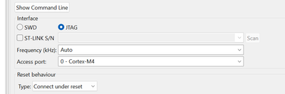

As I see jlink with both SWD and JTAG capabilities via ST-LINK V3.
Both work correctly on twin board that is OK.
Tried the following:
Where pin 3 and 2 are connected on pin 8.
So I suppose all is ok.

You could select "SWD" as the connection method, it uses a sub-set of the full JTAG pins.

The first board, the older one, SWD and JTAG operating fully no connection problems whatsoever.
The 2 recent boards, SWD, JTAG, even connect under reset with Boot 0 = 1, no connection.

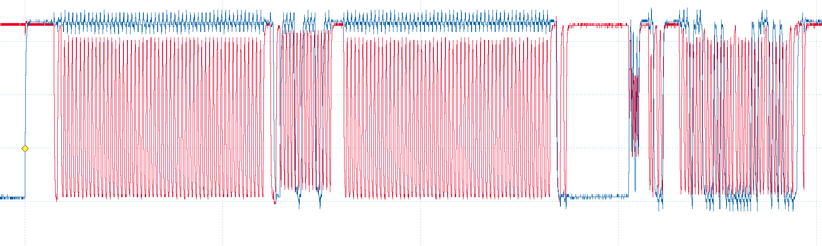

I connected my scope to the board and this gave me the following image: (SWD connection, red is clock)
Do you have any idea what kind of protocol I need to select or any other insights that could lead to the solution i.e. my ST-LINK programmer finding the target board?
