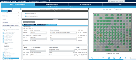

Understand SensorDemoBLE configuration (BlueNRG-M2 chipset)
My STWIN.box board have a BlueNRG-M2 chipset connected to a MCU.
I decided to get X-CUBE-BLE2 middleware, and I get SensorDemoBLE application from this latter. My goal is to learn how to use BlueNRG-M2 chipset.
There is some configuration that I dont understand under the (.ioc) file of the project.
To better understand, here is a photo of the (.ioc) :

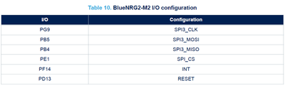

And here is a photo of the documentation of my board concerning the PIN configuration of the blueNRG-M2 chipset :
So here's my question's :
1) Does PF14 PIN (that is INT) is well configured when I choose : GPIO_EXTI14 from (.ioc) file ?
2) Does PD13 PIN (that is RESET) is well configured when I choose : GPIO_Output from (.ioc) file ?
3) From the first photo, the second line of "HCI_TL_Interface" (BUS IO driver) tell that we will communicate from the MCU to the blueNRG-M2 chipset with SPI1 ?
4) What is the second part named "BSP" on the first photo ? Why do we provide another serial communication (like UART 3 from this example) in addition of SPI.
I saw that the BlueNRG-M2 chipset can have both UART and SPI communication, so that make sense, but I dont get the utility of BSP. I saw only a little paragraph in a documentation saying that is Board Support Package, and its use to "provide a programming interface for certain board-specific peripherals like LEDs, user buttons, etc.".
Is it used to let the BlueNRG-M2 chipset "communicate" with a LED and a Button (because I had to mention a LED Pin and a Button Pin, in the first photo).
Thanks for your help.
yes, this is used by the BLE chip when there is something to process on the BLE interface.
yes, this is used to reset the BLE chip from the STM32U585
Yes, and I think this is a mistake because the user manual states that SPI3 is the default one on PB4/PB5/PG9.
This is for configuring common peripherals like LED and button. On a STWIN.box you have LEDs on PH10 and PH12 and a button on PE0.
For the COM port, you might want to use a communication interface in your application to interact with the user or for debug.
USART2 to use the Serial port available on the ST-LinkV3 debug interface on the CN5 connector.
USART3 to use the RS485 port on J1.
In any case please check the schematic that is shown in the User Manual:
https://www.st.com/resource/en/user_manual/um2965-getting-started-with-the-stevalstwinbx1-sensortile-wireless-industrial-node-development-kit-stmicroelectronics.pdf
