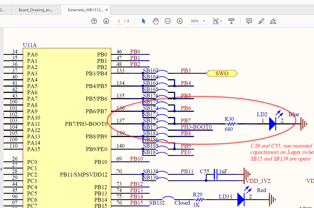

Out of the 3 user LED's Red(PortB ; GPIO_PIN_14)and Green(PORT C ; GPIO_PIN_7) are working as expected, but BLUE LED(PortB ; GPIO_PIN_7) is not working.
Any clue would be of great help.

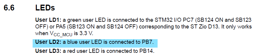

Please check MB1312 schematic and STM32L4R5 datasheet, and if necessary the BOM for Nucleo 144 STM32L4R5 , to check on what pin the blue LED is.
Hi Mike,
I have checked with the schematic.
It is PB7 for Blue LED. Also mentioned in Board_Drawing_en.DM00368330.pdf
SB171 is open and SB172 is closed in the development kit.

Maybe If you have SMPS version of the board, aka NUCLEO-L4R5ZI-P.
It may be connected to PB6 instead.
Checked with the board. It is NUCLEO-L4R5ZI not NUCLEO-L4R5ZI-P.
But I tried now PB6 instead of PB7, still blue LED is not blinking.
