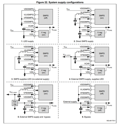

Hello All,
I am facing a problem for debugging one of the board which uses stm32h7 controller.
I am not sure why this is happening but on other board I am able to debug it, but for first one its not working.
Though the code and debug config settings are same for both the board and using same system to debug both, but on one board I am able to debug while on other its is not. so could you please tell me what I can try to resolve this issue.
Thanks,
SD

This is the one used in design. received from hardware team.
Yes actually both have same schematic, one actually works and other doesnt, but the hint is other board which is not able to debug is getting connected on 1000 freq and just after loading the hex in debug mode its giving below error
No. This is a 24V power supply.
I suggest you to get back to your hardware team and check with them what power configuration they adopted in the board for STM32H7?
It could be a hardware issue.. Solder joint issue..
If you have a third board and it connects, I suggest to return that board to your hardware team to check the PCB.
