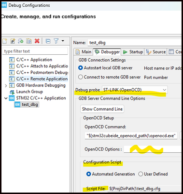

 I make a guess that the item on the left, "GDB Hardware Debugging" is the correct one
Select "STM32 C/C+ application", then on the debugger tab select Debug probe ST-Link ( OpenOCD) :
Then you can edit the auto-generated script and/or OpenOCD command line options.
Also you can pick your own OpenOCD binary, in the OpenOCD Command field.
As for the patches: this is the public ST fork (note the active branch): https://github.com/STMicroelectronics/OpenOCD
The main OpenOCD project may get changes from that, though I don't know details.
Hi @Pavel A.
I followed your suggestion but the solution wasn't straightforward.
I looked through the generated config file and found the following two source statements:
