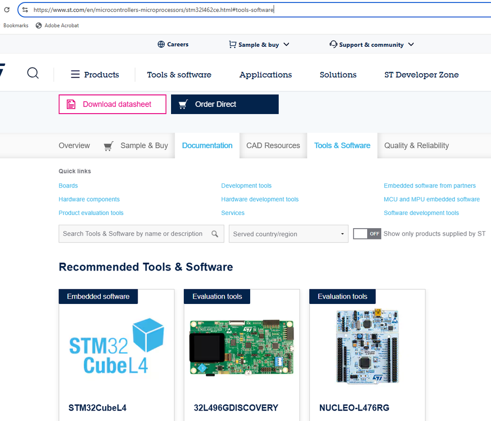

please suggest delevopment board for STM32L462CEU6.

For any ST product, start at the Product Page:
https://www.st.com/en/microcontrollers-microprocessors/stm32l462ce.html
Go to the 'Tools & Software' tab:
https://www.st.com/en/microcontrollers-microprocessors/stm32l462ce.html#tools-software
There you will see all recommended supporting tools - including dev boards:

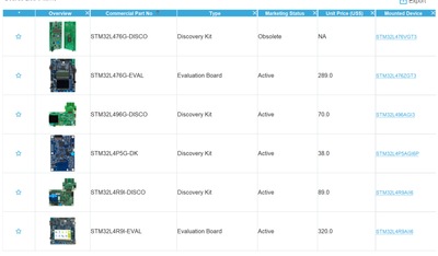

There is no board with that exact chip. Here are all of the ST boards with STM32L4 chips:

No board with the exact chip you've requested exists, the closest is :
B-L462E-CELL1 (murata module)
Board with the STM32L452, same die as STM32L462, but without AES block:
NUCLEO-L452RE
